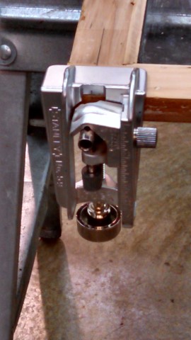

To strengthen the coped joints at the ends of the frame I added a dowel about 2-1/2" long. Here is my dowel jig, an old Stanley #59 fitted for 1/4" dowel guide to drill the holes.
[ATTACH]25961[/ATTACH]

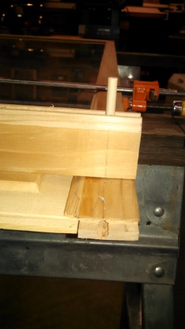

Fitted with dowel.
[ATTACH]25962[/ATTACH]

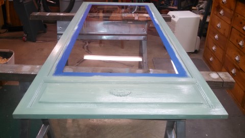

The door was tapped and primed with white latex paint after calking. Then finished in it's final color.
[ATTACH]25963[/ATTACH]

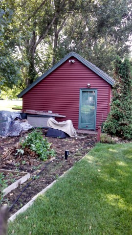

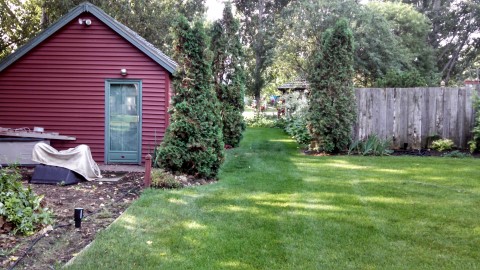

Here is the door mounted on the north side of my machine shed. The medallion was painted red to match the siding.
[ATTACH]25964[/ATTACH]
[ATTACH]25965[/ATTACH]
