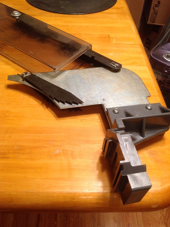

The 1981 model 500 I bought came with an upgraded saw guard (see pic) but not the mounting block, so I bought one.
To determine the exact mounting location on the worktable bar, I need to know how the saw guard sits on the table. Does the clear plastic shield sit flat on the surface or is it raised a little bit above the worktable? The mounting block looks like it can be attached to raise up the back of the saw guard about half an inch. Thanks.

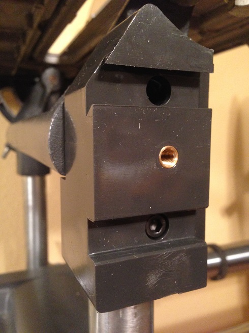

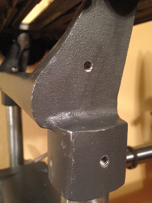

Well, that wasn't too bad after all, the drilling and taping for the saw guard mounting block.
When I was at Home Depot I saw that Dewalt sells the 1/4"-20 tap with the matching drill bit that is needed for the tap and die holes, so I gave it a shot. Don't have to buy a whole tap and die set. Pretty darn easy to do considering I've never tapped a hole before. The metal is relatively soft so the drill bit and the tap punched through in no time. I probably could have gone with a combo I saw where the drill and tap were one piece. Just put it in your drill and it taps the hole as you drill. Of course, you will need a reversible drill to back it out.
I wonder why the previous owner didn't do this since all he needed was the mounting block.
I thought I'd post pics in case someone else is wondering about doing the same.
