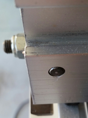

The pin at the rear of my 520 fence tends to migrate out with use. Typically, I don't notice it until I am cutting a board and it hits the pin. Then I tap it back in and all is good for a while. Is there something I can do to make it stay where it belongs?

You'll get a more "eloquent" solution I'm sure but what I would do the next time is shows it's head is to put a drop of CA (superglue) on it and tap it back in flush.

I suggest that you call Shopsmith and ask them. It may be a warranty issue.
I am unable to determine how the pin is held in place. I suspect it is wedged in under pressure.

IF it IS wedged in, I would suggest BLUE loctite.
What is it's function???
Re: 520 Fence Rear Pin
The pin serves as the 'pivot point' for the rear fence lock mechanism.

Bill I used red loctite on one of mine. Now it stays put. Not very likely you would ever need to remove it.

I'll try the loctite. Thanks to all for the suggestions.
