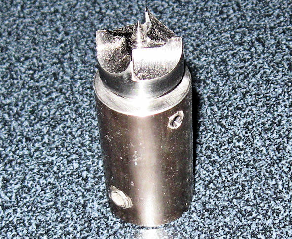

Here is a homemade spur center:
[ATTACH]12867[/ATTACH]

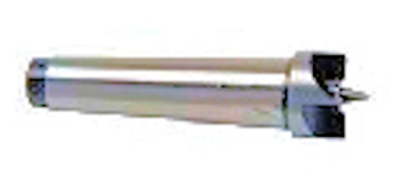

It was made from a purchased mt2 center ($11 locally) like this:
[ATTACH]12869[/ATTACH]
It was made by turning the shaft of the mt2 to 5/8" diameter in a metal lathe, cutting it off about 0.5" behind the head and pressing it into a 1.8" long piece of the tube. It is pinned with a 3/16" roll pin.
homemade spur center.jpg (156.07 KiB) Viewed 3807 times
mt2 spur ctr2.jpg (19.71 KiB) Viewed 3785 times
