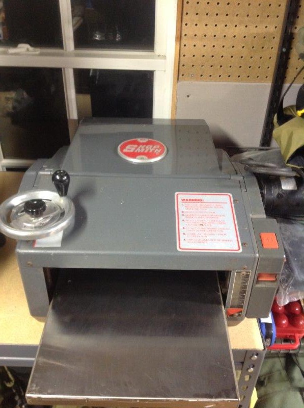

Any ideas on how to remove the plastic coating on the table? It is cracked and not easily peeled off... Looks like the previous owners just left in on.
I thought of using a heat gun, but would that damage the table?
The Sawdust sessions on the planer have been helpful in cleaning it up.
Re: Pro Planer Purchase/Got Lucky
Goo Gone? Lacquer thinner? Mineral Spirits? Alcohol?
Whatever works!

Finally got the planer cleaned up... I had to use mineral spirits, a razor blade scraper, and a green scrub pad to remove the protective coating on the table. There were cobwebs under the table and on the chain... It was sitting for some time. There's still some rust to clean up on the tie bars.
