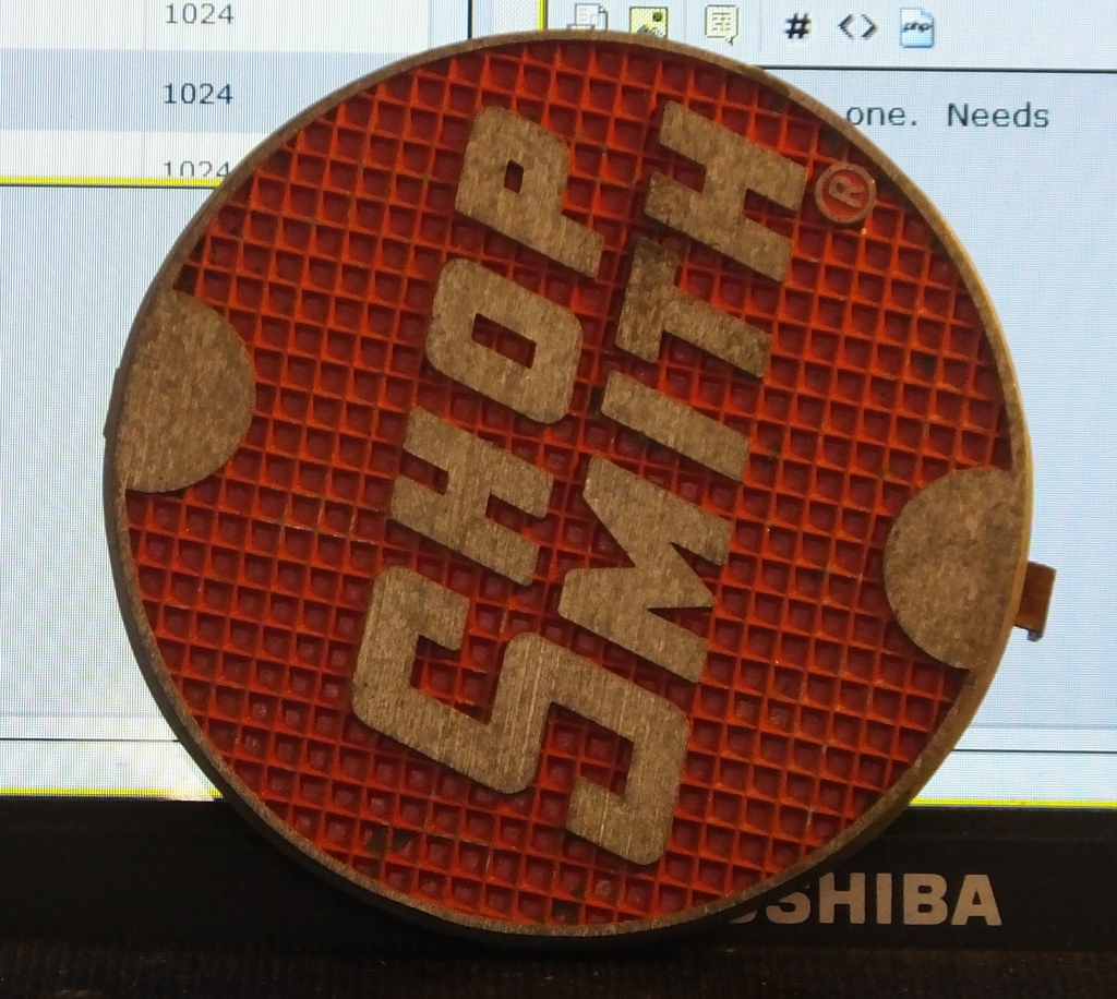

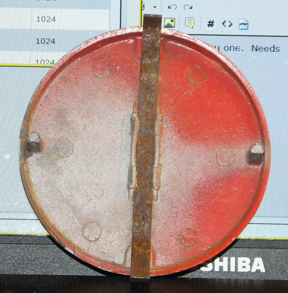

My son and I had picked up his new to him 1978 shopsmith last week and while most of my last week was dealing with staying alive this coming week will be more to the not lifting more then 5 pounds and doing some research on parts for the 78.
The name plate (now called logo cover) fell off as the duct tape had turned to dust. A common problem once the little spring thing comes off. No idea where the spring is and while it might turn up I'm not counting on that as repair route. Why? Because my hunch says it gone due to finding a brand new logo cover in the boxes.
Before we get to excited, the logo cover is the new larger version for the newer headstock. A search did not find anyone documenting the conversion but the search engine is limited by what naming that was used in a post and it could be I missed it.......... So does anyone recalling seeing such a posting?
BTW shopsmith still lists the old version 504241 with a cost of $31.84, for that price we might be as well off making our own adjustments for what we have in hand or go for the full conversion.
Any thought are welcome.
1978 model in for repairs/rebuild/updates

[ATTACH]26730[/ATTACH]
[ATTACH]26731[/ATTACH]
- inspection plate 3.jpg (810.67 KiB) Viewed 2399 times
- inspection plate 4.jpg (669.5 KiB) Viewed 2397 times

I have a question about these.
Does anyone know a way to make them less loosey goosey?
Mine vibrates making a awful racket. I have considered taking it off and leaving it off.
I think the new ones are held in with a screw but I think that would take considerable modification to do it. Perhaps not.
Any ideas????

On the 4 machines I have they are all tight. Might be luck of the draw or could yours have had something happen it it?Ed in Tampa wrote:I have a question about these.

The modification that you are speaking of is the same one I had ask about and while I now have a solution to my issue it would still be nice to hear what others have done by way of solving their issues.
I was thinking that the hole size/mounting changed was with the "C" housing but I not sure. So or are any "B" headstocks fitted that way?
If it were me, I would try a bead of silicon around the edge. Once it dries, you can trim the excess. You would still be able to remove it easy enough. Actually, since you aren't trying to seal it, a few dobs of silicon around the circumference would probably be enough to stop the chattering.Ed in Tampa wrote:I have a question about these.

I think the larger access hole was born with the "C" casting.
