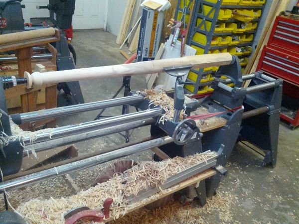

Short version sand with another Shopsmith or two Shopsmiths end to end 80 to 400 grit paper or spin with a drill if you only have one Shopsmith. I use tapered wooden plugs at the ends of the tubes. Haven't ever tried the rotten potato method though.
Another option I thought about as I was writing this, if you only have one Shopsmith, put the headstock in a maintenance cradle with a 2x4 between it and the lathe end support.
I did cover Mark 7 tubes prior to sanding.

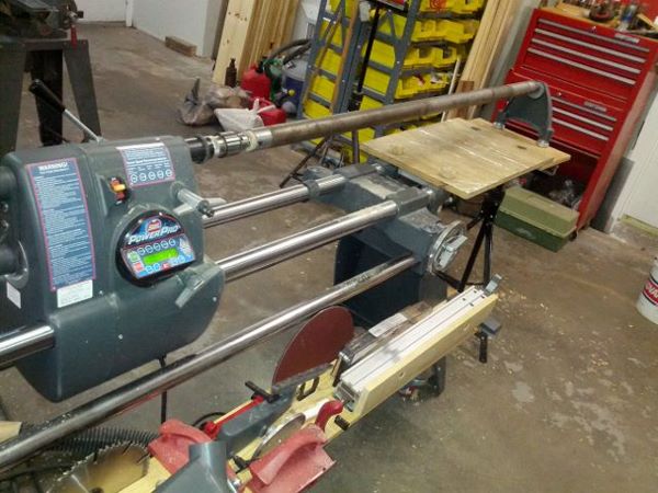

On this one I used the second set of holes on the mini SPT storage rack and moved the headstock further to the right.

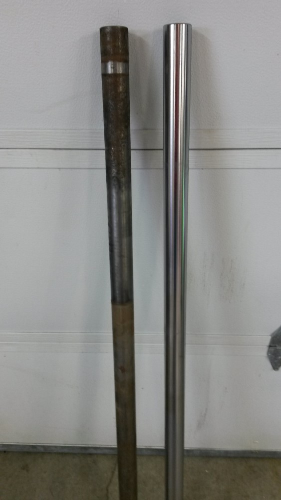

There are a number of ways to remove rust from the tubes. The main thing to remember is not to remove good metal and NOT to reduce the diameter of the tubes.
For rust removal on way tubes I start by putting a way tube in a 3" diameter PVC pipe tube with a glued on cap at one end and a slip on cap on the other end. I fill it with about a gallon of vinegar which is much cheaper than evapo rust but takes longer. After a couple of days it comes out, gets cleaned, rinsed off, dried and is ready for the next step. It than gets mounted on my Mark V with a special chuck adapter I made and the other end rests on two rollers mounted to a board on the extension table. It then gets polished. Below is a picture of a way tube set from a Model 10ER showing a before and after.
This set wasn't as rusty as some but I have had similar results with tubes in worse shape. Like what Dennis showed in his link they can be "brought back to life."
