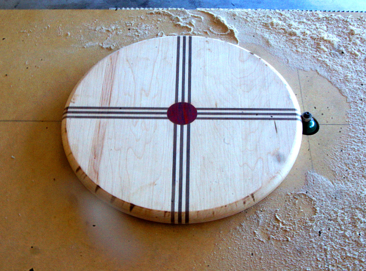

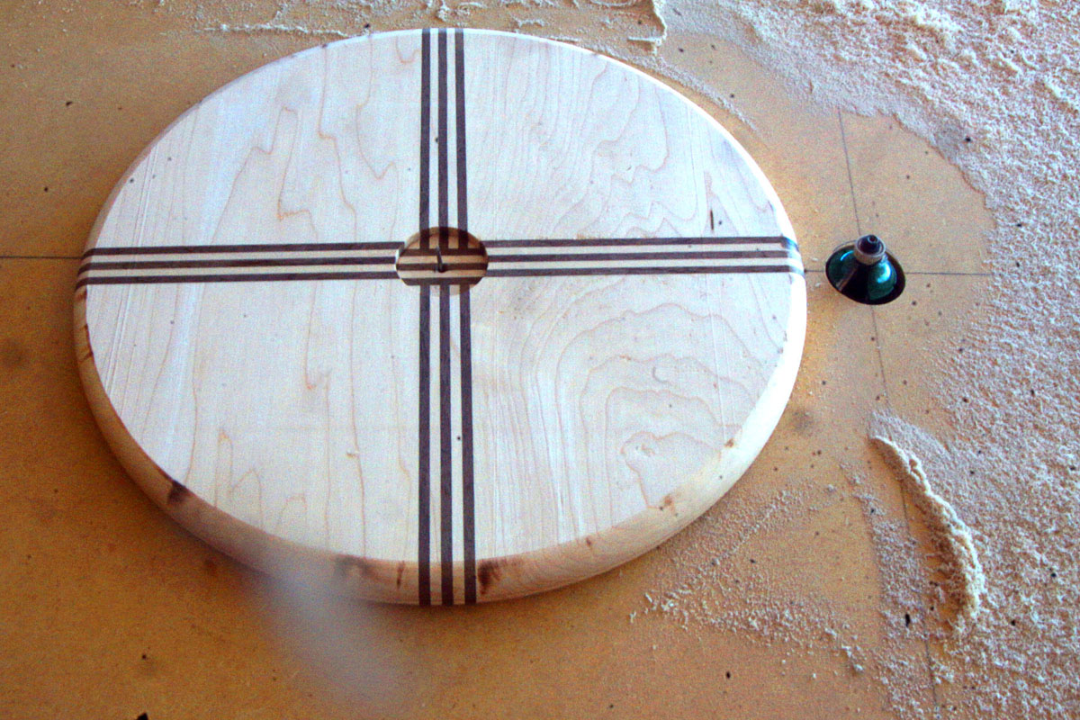

Thanks for all of your comments and suggestions. Since this was a new procedure for me, I pulled out solid info from each post and decided to use caution. I went with a "belt and suspenders" approach, using a router table, my circle cutting jig/board, a guide bearing, and a center pivot. "...no joy in Mudville...Casey struck out." What I feared would happen happened--burn.
What do you think went wrong?
Thanks
Re: Need some help
gr8mesquite wrote:... "...no joy in Mudville...Casey struck out." What I feared would happen happened--burn.
Thanks
I believe you have over-thought this proceedure. The center point of your rounded piece was probably right on, however just a slight out of round edge will give you this burning.
It would have been best if you did not tie down the wood. Really - all you need to do is pass the wood slightly against the router bit. For example rout about an inch then rout another inch and keep doing this until the entire circumference is done.
You may be able to get rid of those burns by sanding, but what I'd do is to elevate the bit a few thousanths and do it again - section by section. If you can't slow down your router, then move the wood faster. The bearing on the bit will keep the edge straight.
If the bearing on the bit is above the curve you will get a slight ridge along the edge. This can be sanded to eliminate the ridge.
