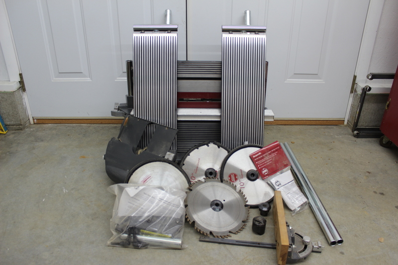

I have some 510 parts that includes most everything you need. I will post some pics.(if I can figure out how real quick) then you can contact me. These parts are of no use to me right now so I will part with to help a fellow WW

Not to butt in, but I might be quite interested in what you have shown there ron hubbard. If it isn't already taken or spoken for.
pm me if its still available or reply here if it isn't.
