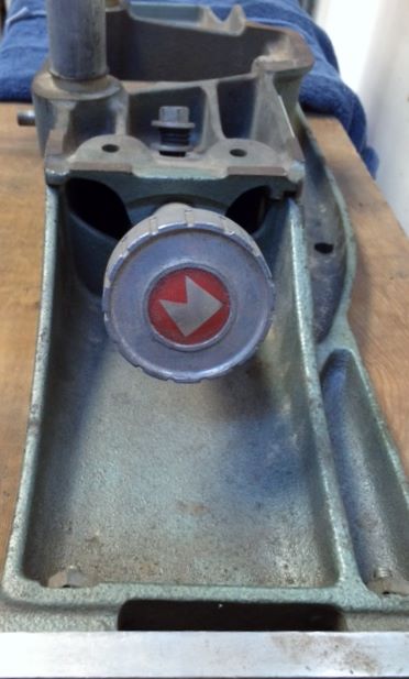

greasemonkey2275 wrote:
JPG wrote:How about a pix of the 'mystery' spring.
Here are the pics.
Looks like a broken A2948.

JPG wrote:Looks like a broken A2948.
I would have thought the same thing but I never took that part out.
So! Where did thee remove it from? :D
Was it under p1451?

JPG wrote:Was it under p1451?
That would make sense especially since my model does not have any spring washers. Good call; I'll give it a try tomorrow.
Jake
FWIW the 'spring washers' look like split lock washers(very thick).

JPG wrote:So! Where did thee remove it from?
As I was laying there in bed this morning I was thinking again about where that spring came from. I reached over, grabbed my phone, and started going through my SS pics and lo and behold I found it! :D
I recommend getting the current spring washers.
