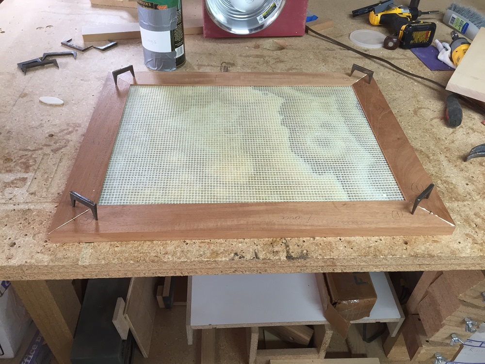

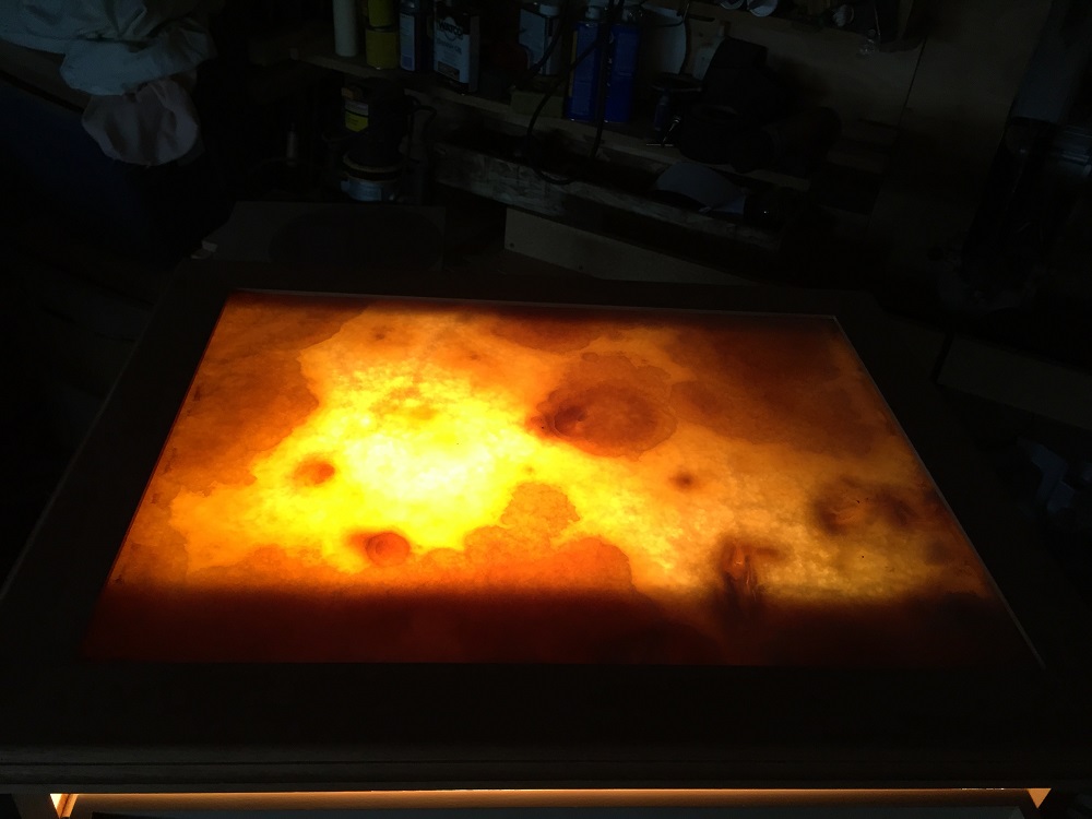

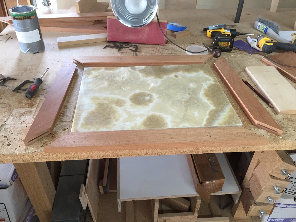

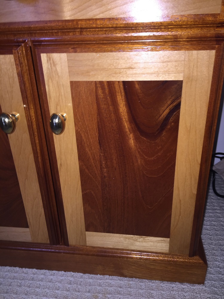

I got the onyx frames made and will attach them to the cabinets hopefully today. I set a frame on one of the cabinets and put a flood light under it for a lighting test. It going to take a lot more light than I thought to get the level of illumination the boss wants. My newest theory is to use 3/16 mirror as the tray to glue the led's to. Not only will it give me more lumens with the bounce back but also I believe the glass surface will allow for better adhesion of the light strips. We will see.

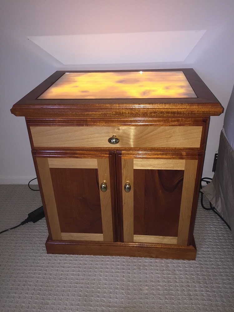

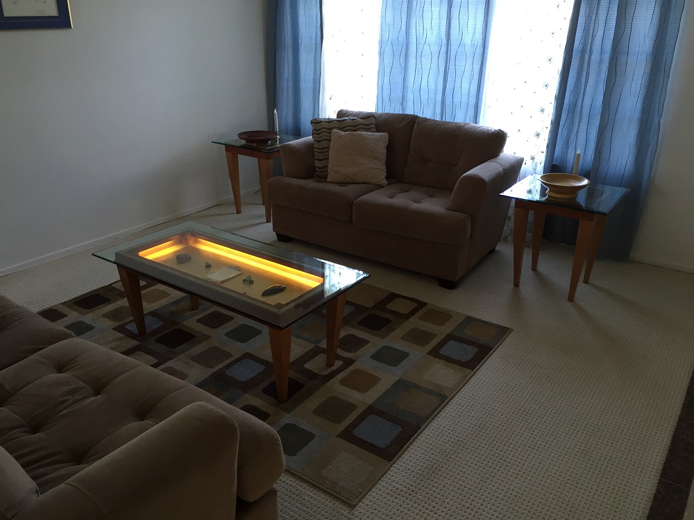

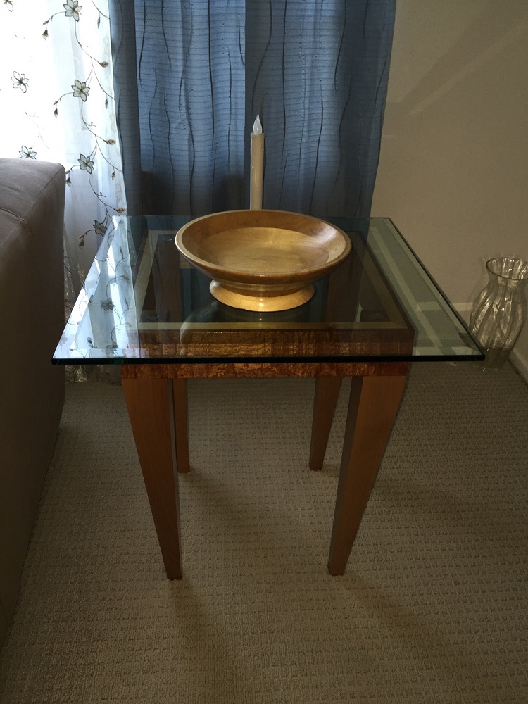

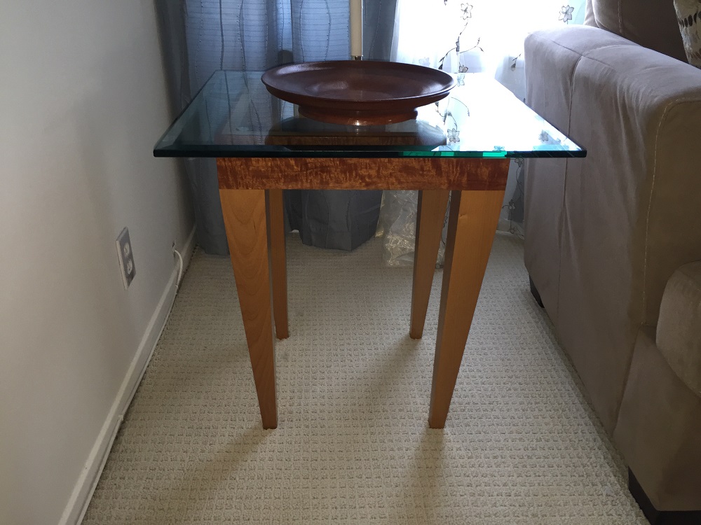

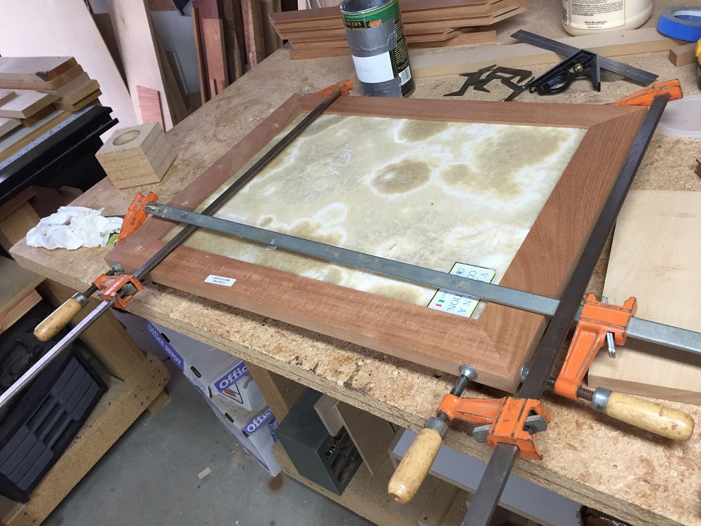

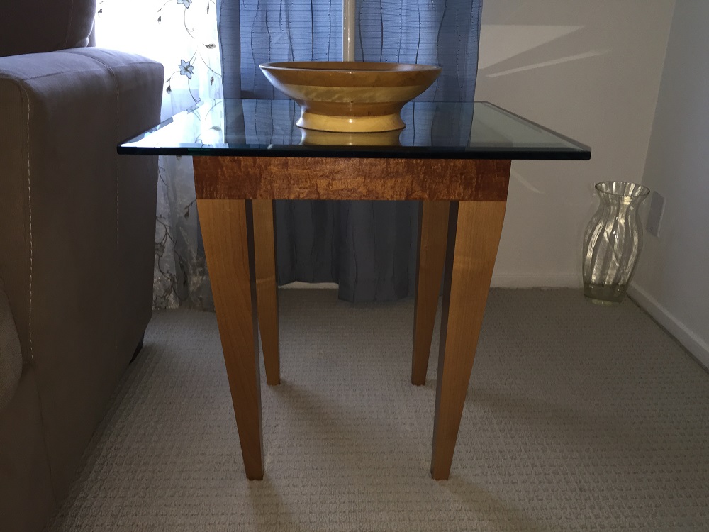

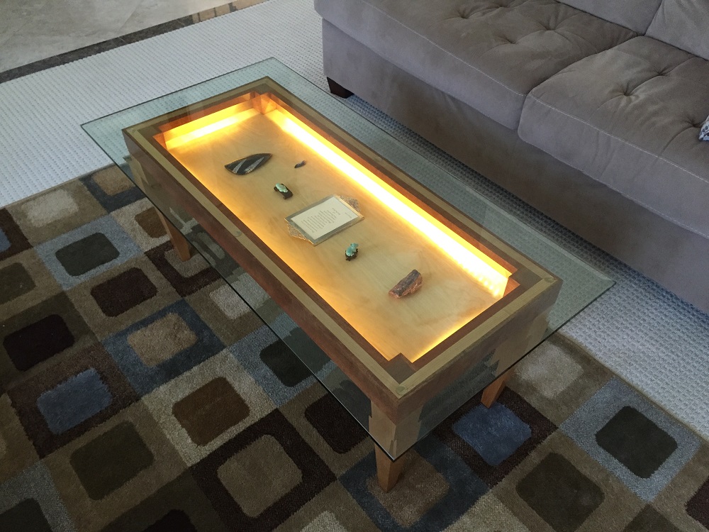

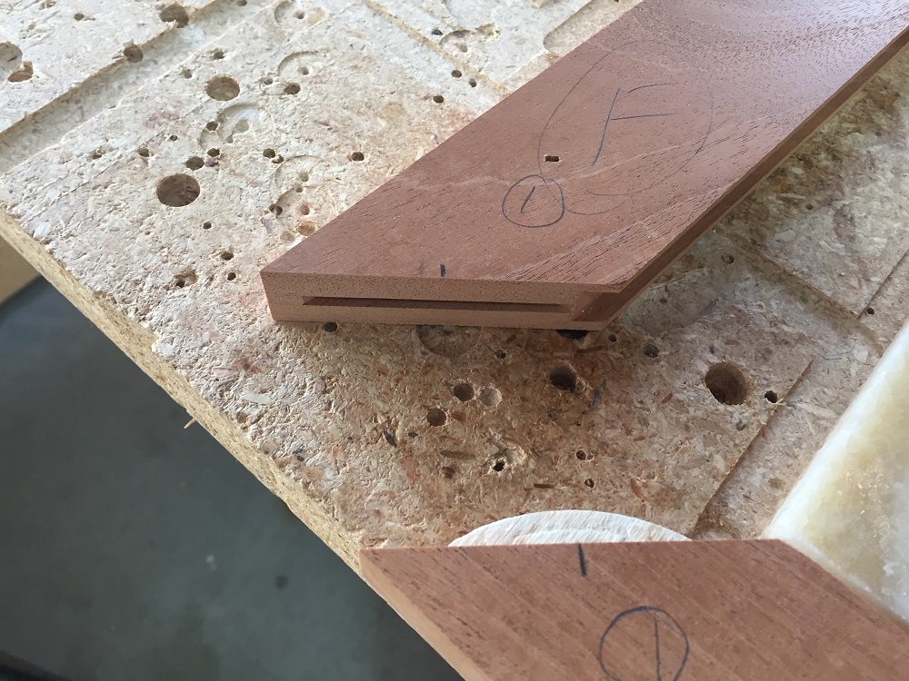

Well we are all moved in and the shop has been functional for a few weeks. I have managed to get several projects finished the last two weeks. First were the onyx topped bedside stands and then the living room coffee/display table and two end tables. I also included a picture of us preparing the light panels for the onyx. All were made from alder and Honduran mahogany with Watco finish.
