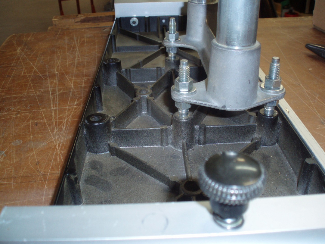

Why do you prefer the tables with hubs? I've often wanted one without the hubs so I could snug the fence rails between the main table and extension/floating tables.dusty wrote:I don't believe I understand the issue here. Why can you not just move the headstock and carriage away from the extension table an inch or two (or whatever)?wdelliott wrote:I wonder if anyone has this problem. When I mount my router table (555865) between my main table and the extension table, the fit is exceedingly tight. the two hubs (1 inch square) on the edge of the main table seem to block or hinder the fit.
I was thinking of creating an insert space on my router table to accommodate the two hubs so that my fit would be not so tight.
Any thoughts on how to make my fit a little easier?
A picture with the tables in the interference mode would help.
The square "hubs" went away when Shopsmith redesigned the table (the mold for the old table was worn out) and I wish they had never done that. I prefer the tables with the square hubs. I believe the change was for ease of manufacturing and had nothing to do with utility of the tables.

No pictures necessary. I just came in from the shop where I took some measurements of the space between the inside edge of the extension table and the left hand edge of the main table (the space where one would mount the router table). It is a rather close fit. Much closer than I had thought.dusty wrote:I don't believe I understand the issue here. Why can you not just move the headstock and carriage away from the extension table an inch or two (or whatever)?wdelliott wrote:I wonder if anyone has this problem. When I mount my router table (555865) between my main table and the extension table, the fit is exceedingly tight. the two hubs (1 inch square) on the edge of the main table seem to block or hinder the fit.
I did notice one thing that might help. The extension table can be mounted two different ways. It might be that by remounting the extension table using the alternate set of holes you would have more room.
Relocating the the extension table provides an additional 3" of space between the main table and the extension table (one method compared to the other).

Algal has described the situation correctly and kindly posted the photos similar to my situation. The square nubs shown in his photo are what I'm seeing in my 520.
The tight fit is only when when I insert the router table between the main table and the fixed extension table. The tubes slide smoothly, once I have proper fit and alignment on the rails. My problem is just squeezing that table in between the main table and fixed extension table. Yes, the main table is moved to the left to the maximum extent. In all other set ups, such as when the router table is on the outside (and not in between), set up is smooth.
Now that I reflect on Algal's comments, the tight fit is the result of the 520 rails on the router table are just a bit too tight, and thus, perhaps long.
I loosened the bolts underneath the fixed extension table and reset the table, which had the effect of moving the table slightly, every so slightly, to the outside. This helped.
Thanks everyone. I'll keeping working on it.

Dusty, I just posted a reply to Algal, but you are correct also. I loosened the bolts, pushed the fixed extension table every so slightly, to the outside, and this opened everything up by just a bit, which seems to help. The margins are tight, but this little move helped.

I am not understanding this issue at all. My Shopsmith router table measures 19" wide and if I move the headstock all the way to the left (leaving some room so that the shafts or hubs do not rub), I have 22 1/4" of space into which I can mount the router table. To achieve this clearance you need to remount the extension table as I mention earlier in this thread. Without remounting the extension table, there is only about 19 1/2" of space (a tight fit).
Simple solution (it seems). Remount the extension table.
