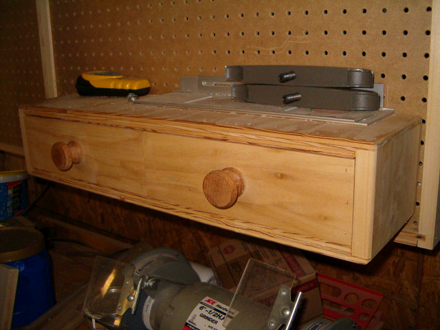

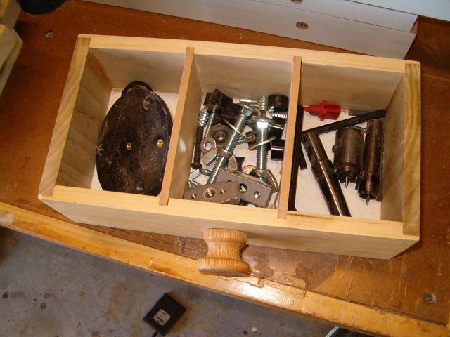

The new drawers look like these (that you have seen before) I mounted the unit just above the double unit (second photo) So now I have four drawers and two shelves.
