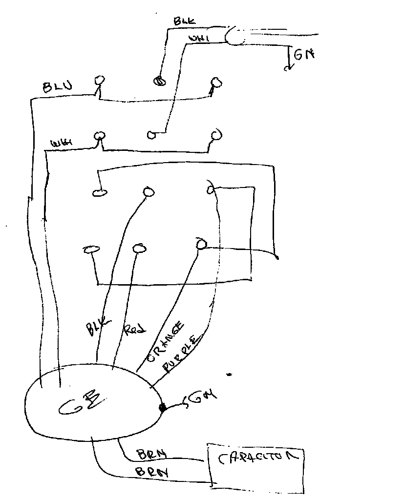

exactly which wires are connected to the forward / reverse switch. There must be 10+ wires attached to old push switch. Thanks for the help
Re: motor reversing switch
mark VII 4PDT switch wiring.jpg (113.25 KiB) Viewed 1306 times
The lower two poles are the reversing part. The upper two poles are power on/off.
The wire colors apply to a GE motor. Let me know if yours is an A.O.Smith motor.
The 4pdt was a center off. A reversing switch(DPDT) should not be.
I am assuming your 'push button switch' is on a Mark VII. If not disregard this.
