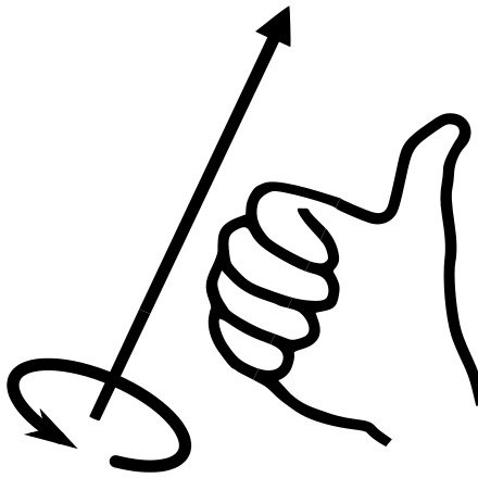

Regarding "the kicker" ... are you sure about that?
A standard headstock provides right-hand rotation. A standard router bit is designed for right-hand rotation.
You can orient the headstock any way you want, and you will still get right-hand rotation. However, if you change the headstock orientation, you may well change your perception of the rotation from clockwise to counterwise, or vice versa, depending on your physical viewpoint. This doesn't require reversing the cutter. But it can require changing the workpiece feed direction (relative to the machine frame).

Regarding "the kicker" ... are you sure about that? YEP!
All true!!!
Being so, requires the cutter to be mounted in the same orientation to the shaft.
Since this modification relocates the headstock from above the table to below, that means the cutter also flips upside down relative to the table top.
One of the things 'scary' about a headstock up operation is the cutter above the workpiece cutting on the top edge. Flipping the headstock moves that to the bottom edge and one feels safer. This top cutting 'mode' has other undesirable traits and is not recommended(digging in etc.) aside from the safety issue.
For those operations done on the bottom edge in headstock up setup requires reversal to cut on the bottom edge in headstock down orientation.
Sorry I did not include sufficient details above.
Other things to consider are fence location and feed direction(climb/plow cutting). ;)

Ah, so! I was thinking router bits (with fixed heads), and you were talking about shaper cutters, which can be mounted either direction on the shaper arbor. You had educated me on that distinction a while back. But the O.P. was talking about using a router arbor, so it didn't click.

JPG wrote:There are 'router bits' that have 'shaped' cutting edges. ;)
Of course. But assuming that we are talking standard right-hand router bits here, they must be used with a right-hand spindle drive. Reversing the Shopsmith motor would give you left-hand spindle drive, and the bit would just burn the workpiece, instead of cutting it.
