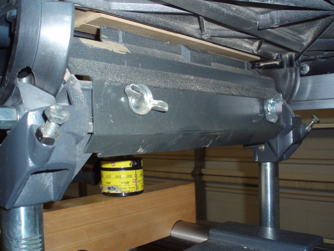

Re: Tiny tweaks that make life easier
Under Table 001.JPG (1.3 MiB) Viewed 1239 times
Yup, I agree. Very nice touch.
Notice the jam nuts on the 45° tilt stop. Those have made it nice too.

dusty wrote:
Great minds and all that.
paulrussell wrote:Sometimes it is the smallest thing that can improve your Shopsmith experience. Here is one I wish I'd done a long time ago. The drill dust collection insert is incompatible with the shield under the table. So I am often taking it off and replacing it. Now the small (10-24) allen screws are thumb screws, no more needing to grab an allen wrench.
I drilled and tapped mine because of what hardware I had on hand at the time. These thumb screws have worked real well.
