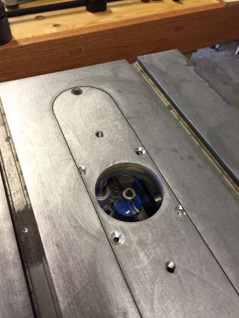

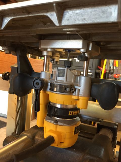

This is what I came up with.
- From Under, mounting to 500 table
- IMG_2415.jpg (49.7 KiB) Viewed 2693 times
- From top.
- IMG_2414.jpg (49.81 KiB) Viewed 2693 times

Re: 500 Table as a router table?
That looks like it will work just fine.
Nice job...
Steve
Nice job...
Steve
- greasemonkey2275
- Posts: 175
That is actually pretty slick TDorey; hope you don't have a patent on that setup because I see another insert for my Greenie in my near future!
Jake
Spokane, WA
Spokane, WA
its ok, trying to figure out how to make a closer insert for it.
One nice thing about it is, the carriage also presses on the base of the router making it firmly in place. I had a hard time finding metric screws for the Dewalt router that were also counter sinkable.
I guess I could make an insert form wood as well.
