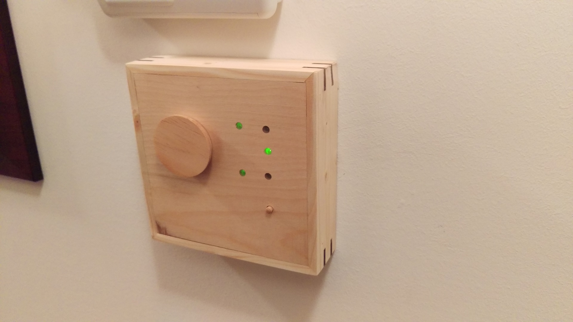

So when I moved into my new home a few years back, the air exchanger controller was missing the cover, which made it very difficult to change any of the settings. Especially since I had no knob to even turn. So today, I changed that situation.
air controller.jpg (316.73 KiB) Viewed 3122 times
I decided to build a replacement cover for the unit. Turned my own knob on the lathe, manufactured a shaft that locks into the knob and the circuit board on the band saw, Did some miter joints with some nice splines for decoration, Routed out a nice slot to place the 1/4" plywood panel, used the drill press to lay precise holes to show the LED indicators, and even used some hot glue to defuse the LED lights towards the front of the panel since they were sunken behind the panel, not to mention there are no holes now. Oh, and almost forgot the spring loaded button on the bottom to change modes.
Now I will just have to find a nice way to label everything. The main reason I made one however, is that they won't sell me the plastic cover, only the entire electrical controller for around $100-$150. So now I have a pine, maple, birch, and walnut controller that is a minimum a conversation piece.

I love it!

Now that is a piece of work! Well done and beautiful!

Nice rescue! Considered laser engraving the labels?

JPG wrote:Nice rescue! Considered laser engraving the labels?
I do not have access to a laser engraver, I may end up doing clear labels onto it, or even attempt a laser printer toner transfer using an iron... Not sure what will be the best approach yet.

No Woodcraft nearby?

Maybe you should consider like a vintage Italian sports car where there are no labels on any of the switches. I think they figure if you are going to mess with it you will know what the buttons and switches are for !

masonsailor2 wrote:Maybe you should consider like a vintage Italian sports car where there are no labels on any of the switches. I think they figure if you are going to mess with it you will know what the buttons and switches are for !
Paul
If only that was the case. I have a picture of an actual cover taped to the wall at the moment to show me the settings. But, maybe i could hide that inside instead lol.
Love the analogy by the way, it may actually sway me to avoid clear labels, etc... Great concept!
