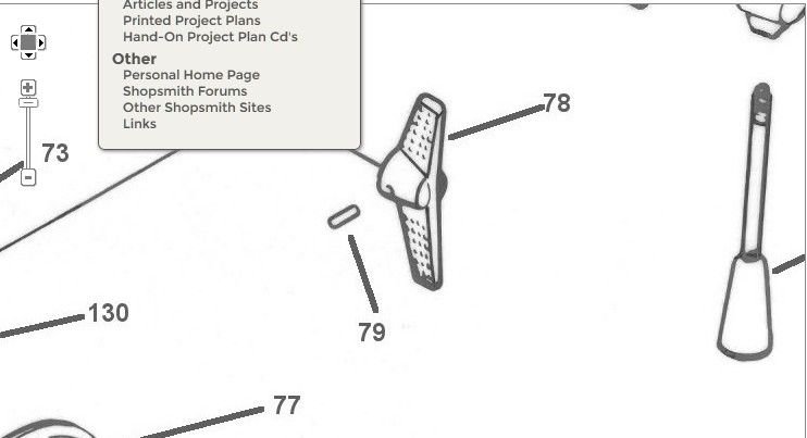

I'm getting ready to order a few things from shopsmith, one it looks like I can not get one unless I order the assy which if not what I want. The rollpin I beleave I once was able to get but not any more.
I think the last time I went to the hardware to get one but they don't carry that length. If memory serves me it might be 7/8" long and they carry 3/4 and 1".
What have other done? I guess I could get a 1" and cut it off with a cut-off wheel or just grind it down.......... Or anyone know where you can find them and not have the shipping make it a $15 item?
Or could this length be used somewhere else on the shopsmith where it might be order-able?

forgot about you Bro, if you think 3/4 gives you enough go with it, easier then cutting the longer one, I think they are tempered or hardened.

They be springs. Yes they be hard!
I would think 3/4" is long enough in that application. Just make sure it is centered on the 'shaft'.
Cutting is also a reasonable work around.

I found the same part number in the Mark V Model 500 Carriage Service Parts List. Looks like I can order it there for $.80. I think I get a couple of them so I don't have to spend so much time looking for them again.
Yes they are very hard....... in my younger years I managed to chip a piece off of one and it hit me just below my right eye, yes right below my safety glasses. This was not a shopsmith project but I learned my lesson well. It was slightly embedded but I got it out without much trouble and just a little blood loss. Surely could have been worse, I'm glad it wasn't.
