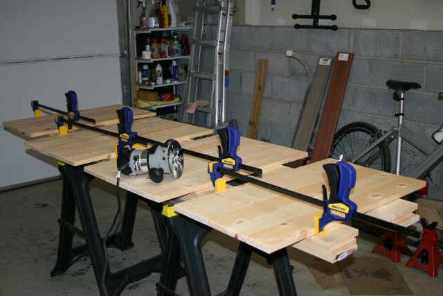

Well, I finally got some time to spend on the shelving project again. First, I spent some time with a router and a roundover bit to round the edges of the shelving slats (click on pictures for larger version):
[ATTACH]1809[/ATTACH]
By rounding the edges, it should be easier to slide things up and onto the shelving. This is important since these will be ceiling-mounted and require some overhead lifting to load/unload them. The next step for the shelving slats is to put a coat of polyurethane on them.
To clamp the slats together, I first clamped them together loosely, aligned all the edges, then clamped them tightly. Even when clamped loosely, I found it was difficult to simply move them inward/outward due to the pressure from their neighbors. However, I found if I wiggled the board up/down while putting pressure inward or outward, I could accurately walk the board into the alignment I wanted. Hopefully that makes sense, I'm not sure if I explained it well. I also found it was important to always ensure there are no uphill ridges in the direction of router travel which would catch the edge of the router plate. I made sure all the joints were totally flat or went slightly downhill (if the boards were slightly wavy).

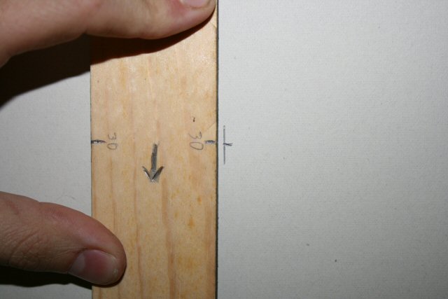

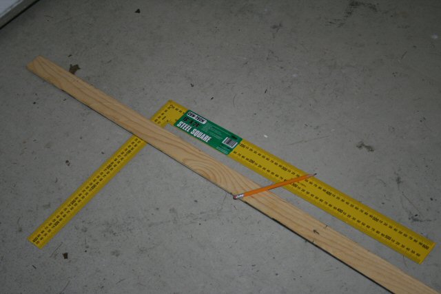

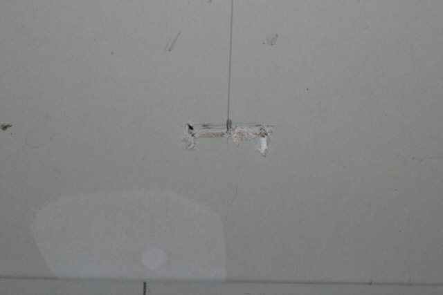

Next it was time to do some more marking on the ceiling. I've already marked the studs right by the front wall by using a Rotozip to draw "I-beam" markings around the stud. The next step is to also mark the stud 30" away from the wall (the position of the other support). Here are the tools:
[ATTACH]1810[/ATTACH]
It's just a cheap 24"x36" square, a long thin piece of scrap wood with a marking at 30", and a pencil. First I went to the existing stud marking by the front wall:
[ATTACH]1812[/ATTACH]
I used the pencil to mark the center of the I-beam marking, then rested the square against the front wall and drew a line perpendicular away from the wall. This line will allow me to see where I need to install the lag bolt when the 2x4 is held up against the ceiling.
Next I held the long piece of scrap wood exactly along the line, and made a "T" marking 30" away from the front wall:
[ATTACH]1811[/ATTACH]
I'll come back to these markings with the Rotozip to determine the stud locations with no uncertainty. I don't like to take chances when things are mounted to ceilings, especially when they are mounted to ceilings over my cars.

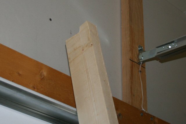

Next I cut a notch in the end of a 2x4x8:
[ATTACH]1813[/ATTACH]

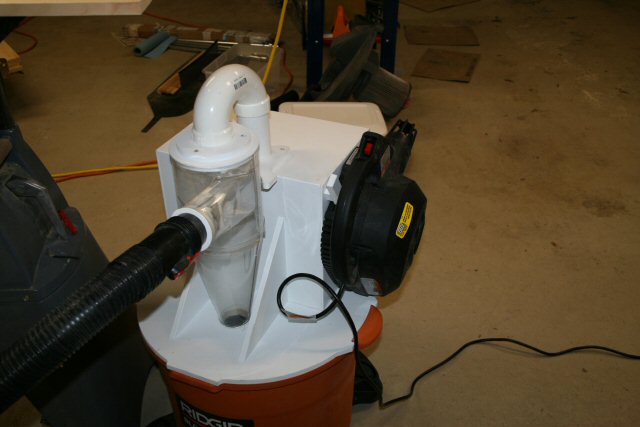

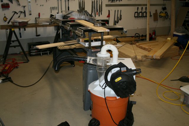

Since the last project update, I've received my dust collection cyclonic separator designed to fit onto a RIDGID shop vacuum. On the particular model vacuums it's meant for (WD1665/WD1670), the motor is detachable to use as a blower. They made use of this and provided a way for the motor to attach to the cyclonic assembly like so:
[ATTACH]1815[/ATTACH]
The nice thing about this is that it reuses the vacuum's collection canister so it can be easily rolled around the shop on its casters. The cyclone separates the collected bits into the canister, and the clean air is pulled straight up and through the U into the filter chamber. Since virtually everything has been sent into the canister except for clean air, the filter in the filter box doesn't get dirty and doesn't clog up.
Here is a view from a different angle:
[ATTACH]1816[/ATTACH]

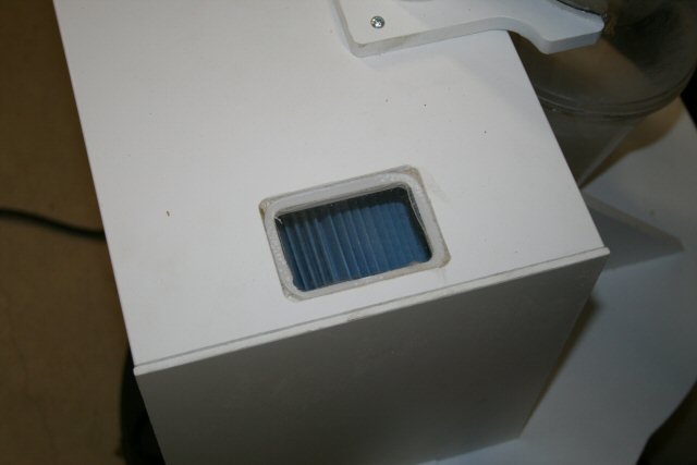

You can see the big square box which is the filter box. A standard RIDGID filter mounts in that box and provides final filtration for air being pulled into the motor and exhausted into the shop. I put a fine filtration filter in there since I don't need to worry about plugging it up with sawdust. There is even an observation window on the top of the filter box:
[ATTACH]1817[/ATTACH]
although it's not much fun to look in since the filter stays clean all the time.
How well does it work? Well, I generated about 1/3 a canister's worth of sawdust during the birdhouse project. There is not a spec of dust, not even fine dust, on the filter in the filter box. The cyclonic separation works exceptionally well. As cuts are made, you can actually see the spiral of sawdust make its way down into the collection canister. It's really neat to watch. The end of the hose slips right into the dust collection port on the Shopsmith. It probably doesn't have the collection power of larger dedicated dust collectors, but it works extremely well for me. The cyclonic separator is designed to be hung by the PVC U pipe on the top, so I put a bike hook on the ceiling by the Shopsmith and I hang the separator out of the way while the shop vacuum performs its normal shop/floor cleaning duties.
You can read more about the RIDGID Conversion Lid at this link.

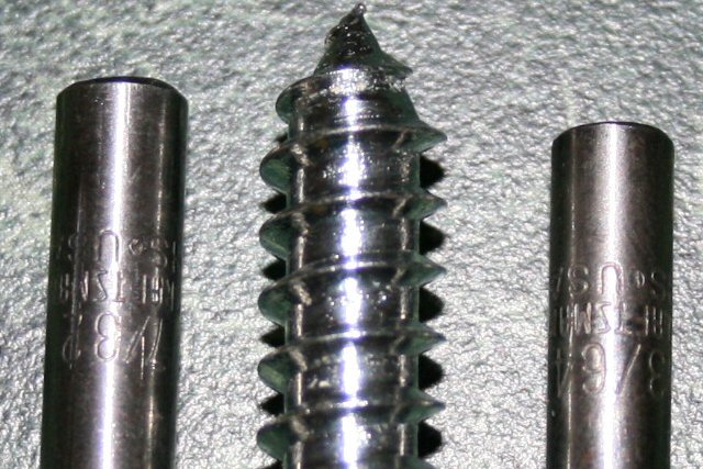

I wanted to choose a drill bit which would work well for the 5/16" lag bolts. I couldn't get my digital calipers straight into the grooves of the lag bolt too well, so I did the next best thing - took a picture with my digital camera and zoomed in:
[ATTACH]1818[/ATTACH]
There are two drill bits next to the lag bolt. The 7/32" bit on the left seems to have the exact same diameter as the lag bolt shaft within the threads. The 13/64" bit on the right is 1/64" smaller, meaning it will compress the pine 1/128" around the circumference of the hole. I drilled test holes for both into a piece of 2x8 scrap, and lag bolts went into both holes snugly with a ratchet/socket without any drama. I am leaning towards the smaller bit since pine is soft. There is about 2.5" of threaded interface into the ceiling joists, so I don't think I need/want to stress the wood any more than necessary. (I've read that for longer lag bolts, you want to keep the pilot hole slightly larger.)

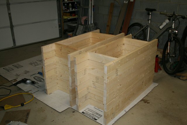

Next I assembled all the posts and supports to get ready for glue & screw:
[ATTACH]1819[/ATTACH]
I am going to paint the exposed end grain in the joints with a mixture of half glue, half water to seal them up, wait two minutes, then glue and screw the joint. The end grains to be treated will be the ends of the vertical 2x4 supports, as well as the sides of the dadoes. After screwing, I will hammer the galvanized strapping across the joint while it's wet. (I didn't want to due this when the joint was cured for fear of cracking the joint.) As each frame is assembled, I will stack it on a new pile like these, ensuring all joints are precisely square for drying. I will put a sheet of newspaper at the joints between the frames so leaking glue does not bond the frames together.
I will probably ask my wife help me with the glue-up since it would be a bit of a race to try to do all of this by myself without getting wood glue all over myself, the drill, and the framing square! We have nitrile rubber gloves and small foam paintbrushes, so I will ask her to be on glue duty during the assembly process.

For what it's worth - my thought is the pre-treatment with 50% mix of glue and water is a useless step. I've always been taught to believe a diluted yellow glue will not have the same bonding strength as non-diluted. If you are using yellow glue like Titebond just apply glue to both pieces of the joint and screw them together. The bond from yellow glue is both physical and molecular. I believe the 50% diluted glue will weaken the molecular bond as well as the physical.
Pre-treatment with glue has been used on miter joints, however the first coating is allowed to dry prior to assembly. This is at least a couple of hours. Curing time is a day or so longer.
You can do a simple check to see if the frames are square. Just measure corner to corner. If the two measurements are equal, it is square.
With the size of lag bolt your using, try a 3/16 drill size. And see how that works. Use washers to.
Hope that notched 2X4 isn't going to carry any weight, I'd be concerned that it would split at the notch if it carries any weight.

I tried a 3/16" bit and that also seems to work well. It's a bit tighter but it's not "squeaky-tight" to the point where snapping the lag bolt will be a concern. I'll probably give all the lag bolts a quick wipe-down or spray-down with some kind of lubricant to help them go in. I do have washers to help spread the loading.
