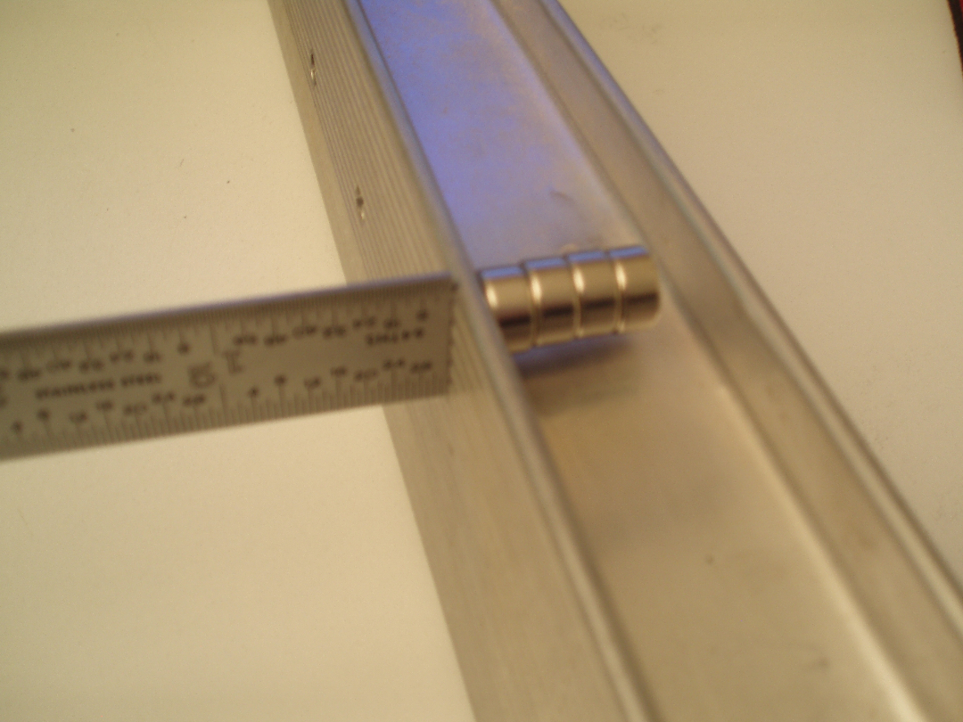

You guys are not thinking out of the box. There is a very simple solution to this problem. At least I think it is simple and I think I understand "the problem". You need (want) a method whereby you can measure the distance from the blade to the face of the rip fence while allowing you to move the rip fence.
If that is the problem, is this a possible solution? (You'll have to use your imagination a little. I am presently unable to go to the shop for this. Imagine that what you see here is your 510 rip fence setting on your Mark 5 Main Table).
The last two images show what needs to be done to the rip fence so that a steel ruler will follow as it is moved back and forth on the Main Table.
I used the magnets that I had on hand. Others may be more appropriate. The magnets would have to be affixed to the underside of the rip fence in the proper location(s) and the steel rule kept available (that would be my problem).
The teeth on the saw blade would be your pointer.
Usable on either side of the rip fence.
I use a 6" rule most of the time but a 12" or 18" ruler will also work. The limiting factors are the strength of the magnets. and the weight of the ruler.

Good idea, Dusty. I guess you would have to glue the magnets to the fence.
