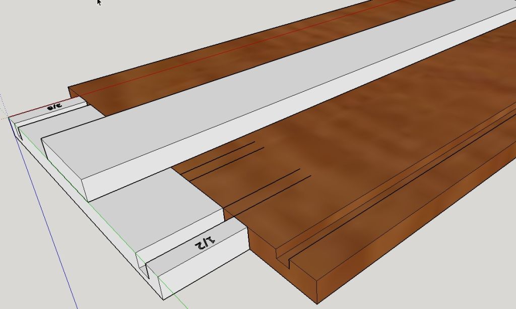

Re: Shop Smith Tip
The end result will look like this but I would not use a t-square for this. A t-square is to light weight and not thick enough. How ever you can make one out of wood and I have done that. If I can locate it I will take a picture of it. For now the sketch will have to do.
ScreenHunter_77 Dec. 18 19.15.jpg (20.88 KiB) Viewed 4632 times

Re: Shop Smith Tip
Post by Bruce »
Seems it would work best if it was a through cut, not a dado. That way you can put the edge right on the layout mark.

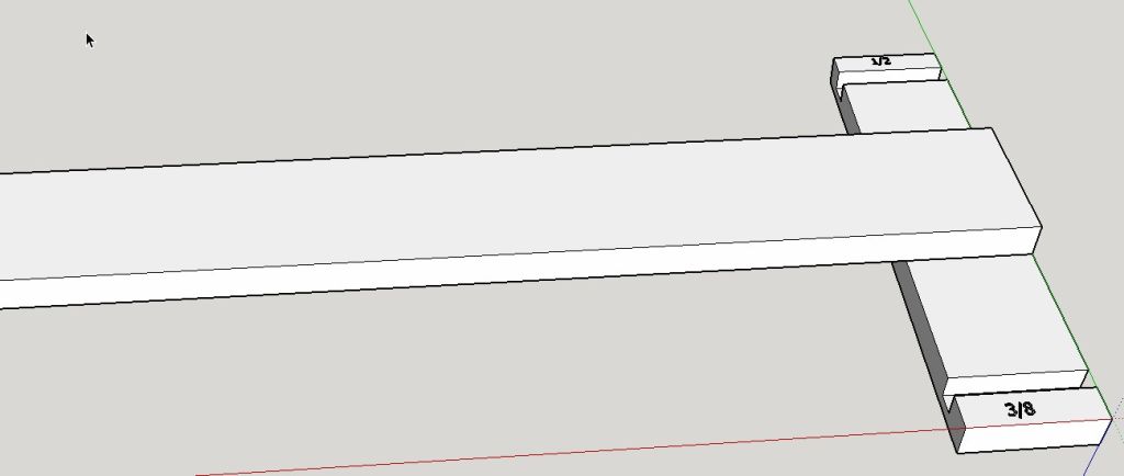

Re: Shop Smith Tip
I've added a work piece so it is more clear how this works. You mark where you want your cuts then align with the cut with the location and route. Move to the next location etc etc. You do have to clamp the jig in place and it only works with a router that has a centered base plate and only for that router...... so if you have saw 3 different router then you could will need three of these each marked with which router it is for.
ScreenHunter_78 Dec. 18 20.10.jpg (56 KiB) Viewed 4600 times
If you cut off the end with a through route then you loose the second location mark but sure it would work.
