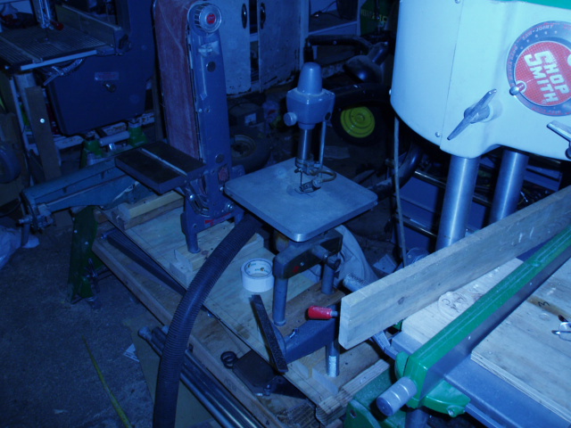

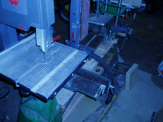

I got a SS510 and an old greenie
I use the greenie as a drill press
than I made a table on the greenie to hold the my jointer, jig saw, belt sander, and lathe tool rest and lathe tail stock
the band saw is on the end of the greenie.
all of them are handy to get to. the greenie is on casters so that I can move it around when needed.
good place to store the accessories and saves space in the shop

lyall wrote:I got a SS510 and an old greenie
That is a good idea! i like it! It sure makes room for the SPT's without modifying machines. Image
