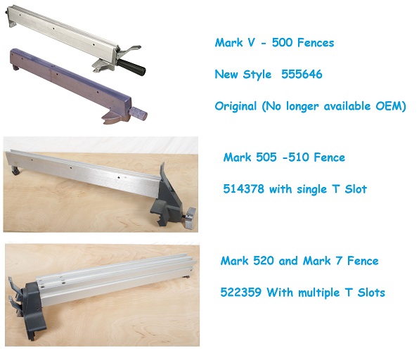

Good Eye - An original document photo error from Shopsmith in 2004
It is indeed the 555646 New style fence for the 500 they show in the second photo opposed to the 514378 for the 505-510 which would be longer (because the table is bigger) and it would have the newer style handle etc.
This kind of thing is why I created the side by side rip fence illustrations as noted in https://www.shopsmith.com/ss_forum/view ... 90#p185690
I am working on other drawings, but have been occupied elsewhere with other projects.
Everett

Re: A different perspective for accessories 500 - 520
This should help...
JPG wrote:Fer sure!everettdavis wrote:This should help...
Now about all them guards.
In time... working at the speed of my available volunteerism you know...
