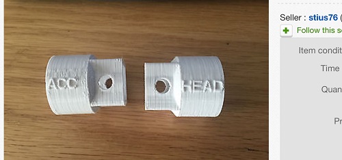

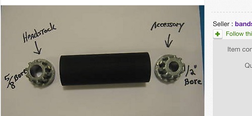

While looking on a popular internet auction site I saw these aftermarket power coupler alternatives. It is interesting what people are doing with these 3-D printers as demonstrated in the first two photos.

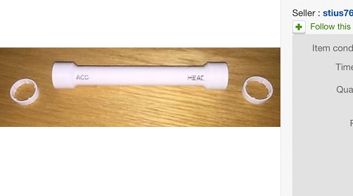

The third photo shows another concept / aftermarket coupler. The rubber coupler might be more forgiving and allow for the same SPT to be used on multiple machines.
Personally I think I will stay with the original equipment. I managed to crack one of my couplers, but it was my fault for not taking the time to properly align the SPT to the headstock..

Post by stigodiy »
I am sorry to hear that you broke your coupler. I have a new design which I think is going to be nearly as robust as the original Zytel shopsmith coupler, however you can make it what ever length you like. I would love to send it to you to try. It is different than the wood dowel version I have on ebay now. I will doing some comparative testing and will post the results as a video on you tube within the next week.
