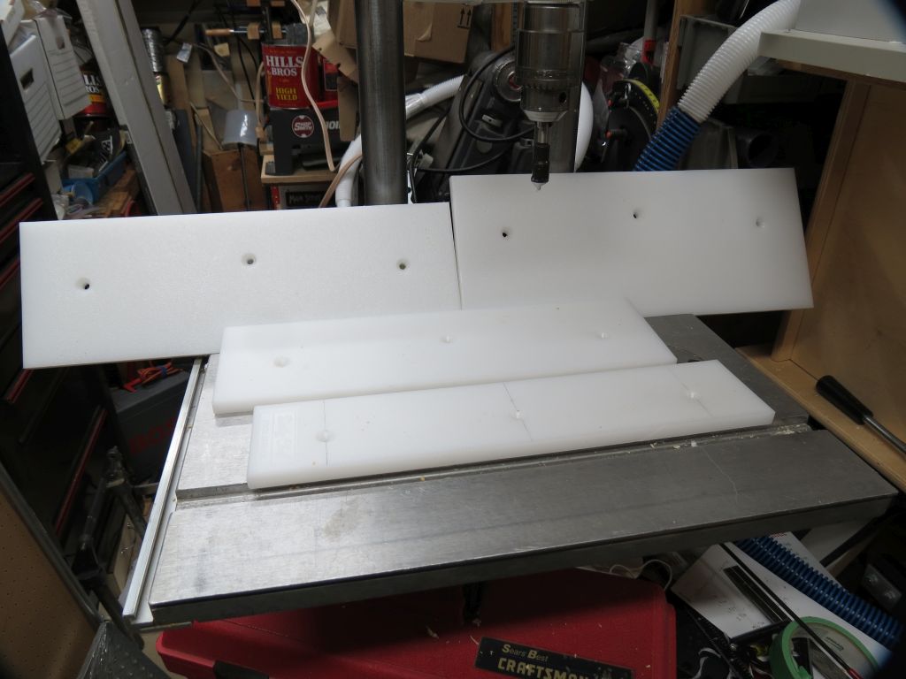

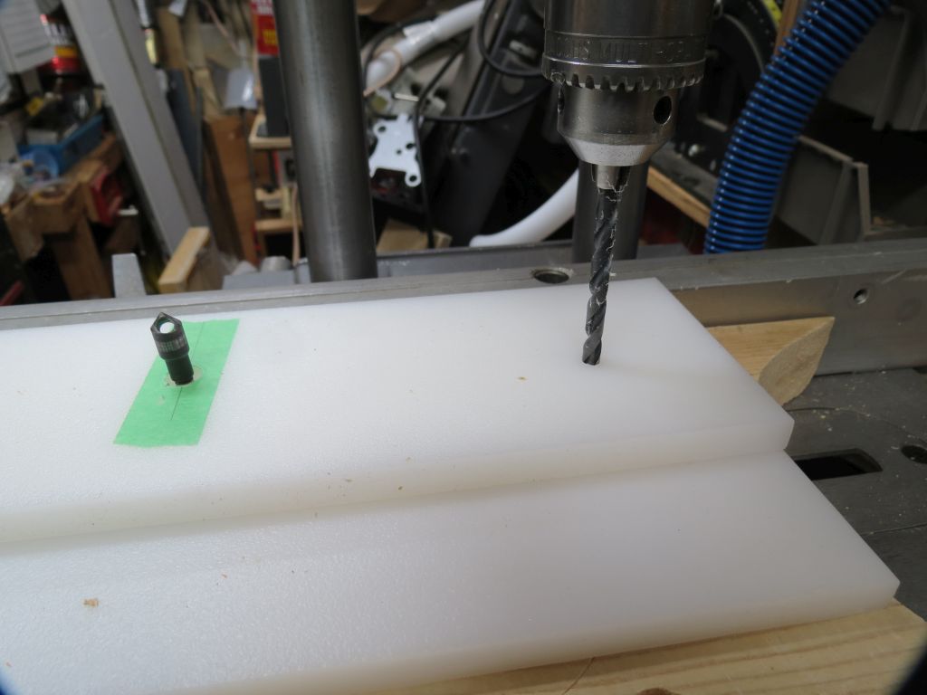

I have 4 pieces of plastic to be drilled and the holes need to be countersunk so the screw head is below the surface. Each piece has 3 holes and the locations are near the ends and in the center. The holes have two differing locations so it is really not a big deal but for purposes of this discussion it illiterates how this method works.

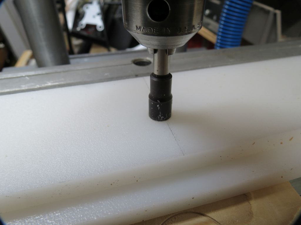

To start I mark one of the pieces so I know where the holes are going to be. I set the fence to control one dimension, which in this case is the importation one. I chuck up the drill.
The first piece all of the holes are the same distance from the fence so I drill them.

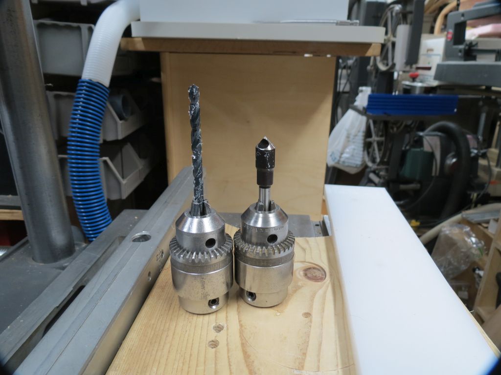

This is where the second chuck comes in to the picture. I mount a countersink in it. So one chuck has the bit the second has the countersink.

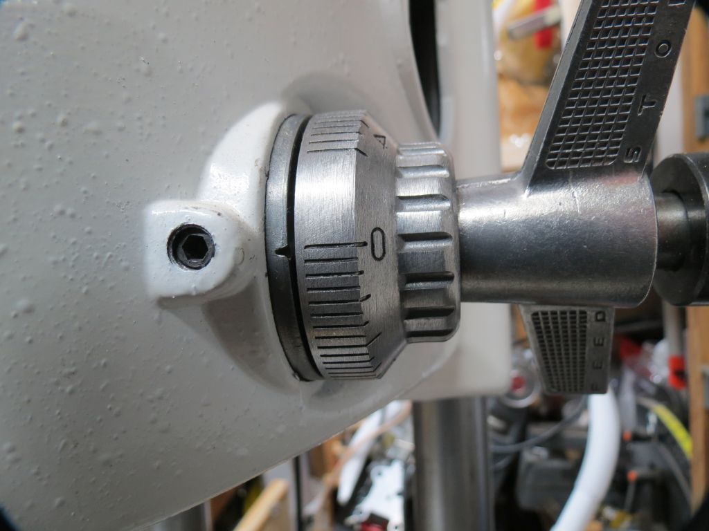

Then it is a mater of getting the countersink adjusted so it makes the hole the right depth.
Now the the depth is adjusted and quill set up to drill all the holes the same depth I've established enough to counter sink the first three holes.

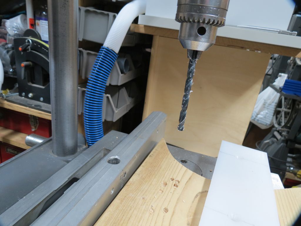

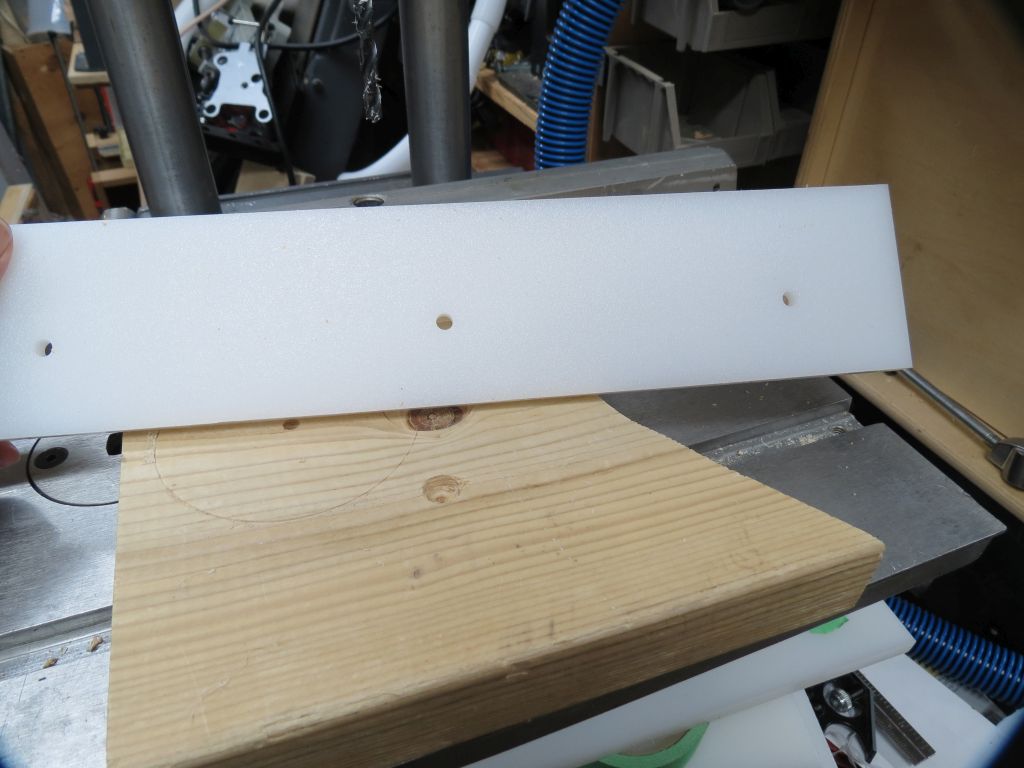

One down and three to go. The next three of these have the same spacing of the holes across the piece and the center hole is the same distance from the fence. So since the fence is at that location I drill that hole on all three of the pieces........ but wait I have to take the countersink chuck off and put the drill bit chuck back in. If I just took the drill bit out and put the countersink bit in and now had to change back I'd loose that depth setting...... so by changing chucks I don't loose the setting. Like I said this is a simple case but think about other times this would be useful, I know you can do it.

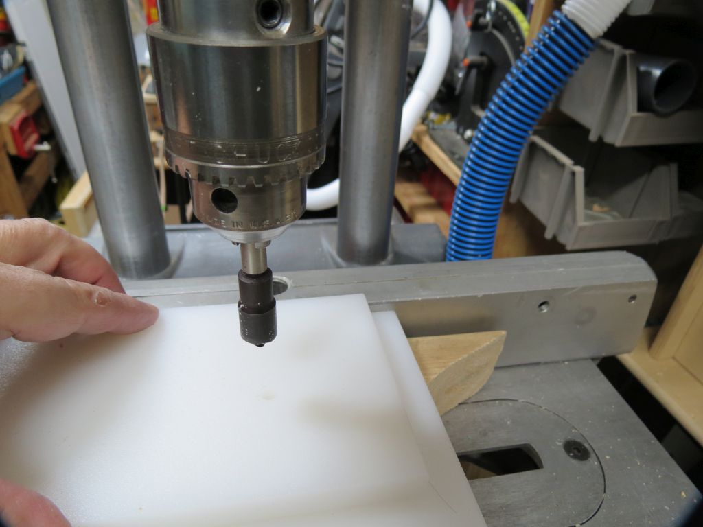

With the center holes drilled I can now drill the other holes. Moving the fence to the new location I'm ready to go but do I really want to mark the other pieces? No not really, but I can use the one part as a template for the others so by slipping this smaller countersink in the hole (it could be anything with a 1/4" shank) I can now use the one part as a template for the others and have the hole in the same locations without measuring or marking anything.
After drilling the holes I can switch back to the countersink and it is still correclly adjusted for the depth so away I go.
