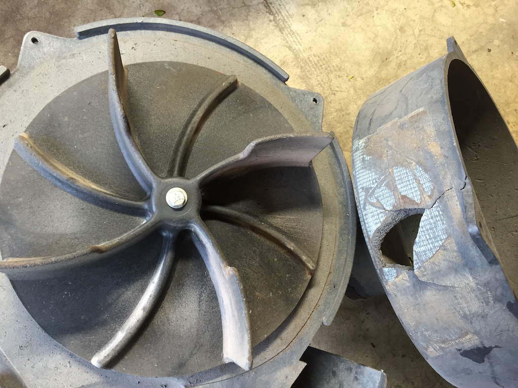

Update - impeller not damaged
Tested the motor briefly and then took the fan housing off and apart. Impeller is undamaged and while I could fix the "puka" in the housing I'm going to call SS first to get feel for what they charge for shipping to Hawaii. The fan housing is priced at $43.00.

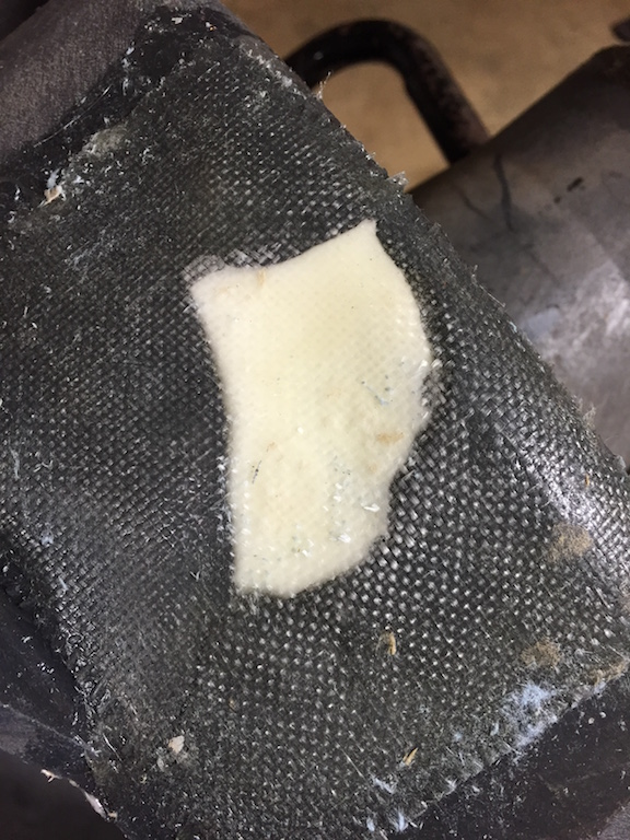

Update to fan housing repair
SS sells a replacement fan housing for about $55 including shipping, very reasonable. But I decided to repair my housing instead. Used fiberglass cloth inside and out, and Q-cell, which is a fine power that forms a filler when mixed with resin. Had these items hanging around the shop, but my resin had gone bad. So I used some 30 minute epoxy instead. A light sanding and coat of grey it should be good to go. Thanks!
