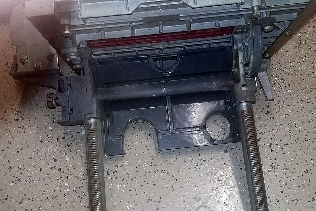

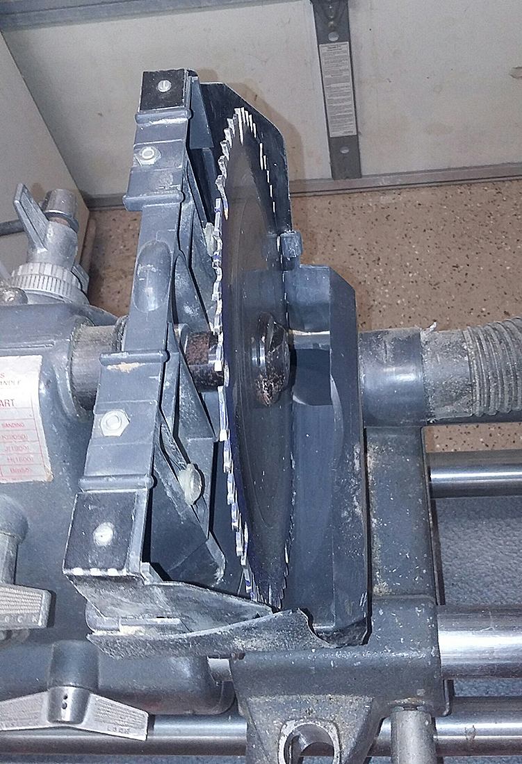

Yes the quill portion does split in two, BUT you can put a dado with extra spacers in there adding up to 1 1/2" without that insert and installing that would help close the gap at the bottom, but would open up the gaps at the top, but making a table insert and extending the quill was quicker,the complete dust chute IS IN 2 Pieces, one attaches to the Headstock and the other half attaches to the table upright tubes.
Attached to Quill, note the quill<br />is extended, so with out that spacer mentioned there is plenty of room for a dado.
guard 500.jpg (801.93 KiB) Viewed 2341 times
Portion that attaches to Table tubes
Portion that attaches to table tubes.jpg (922.93 KiB) Viewed 2341 times

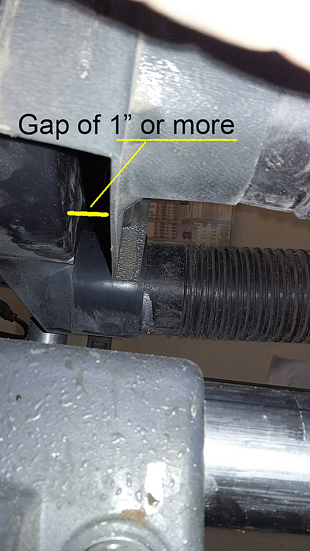

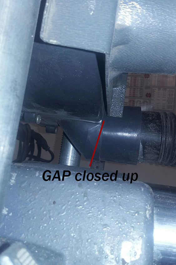

I meant to add these pictures showing the gap closed.
Showing Gap before my modification
Gap between halves.jpg (625.64 KiB) Viewed 2327 times
gap closed.jpg (344.05 KiB) Viewed 2327 times

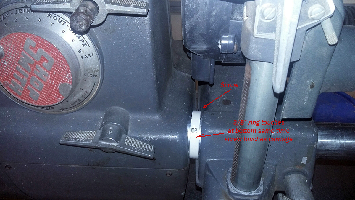

Home made 3/8&quot; ring, showing it touches the same time the screw on the headstock does.
Home made 3/8" ring, showing it touches the same time the screw on the headstock does.

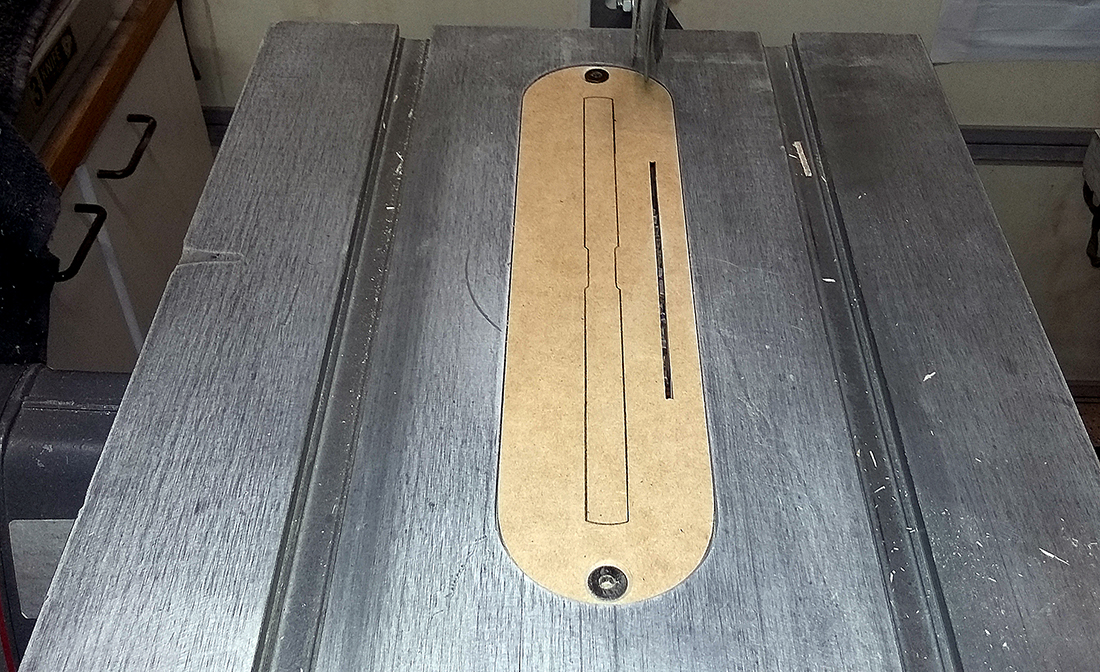

Extendin\g the quill and making a zero insert and this closed the gap.
zero clearance.jpg (716.84 KiB) Viewed 2327 times

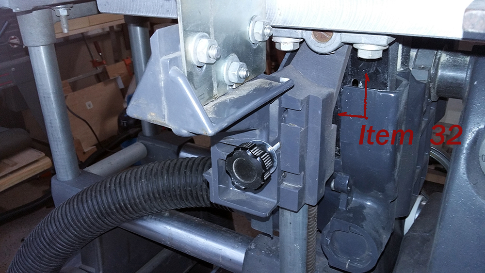

What I haven't seen are the shields that get installed front and back. Are they there?
Also tell me more about this screw that contacts at the 3/8" dimension. What is it attached to again? Perhaps a better picture?

Ed, In the post above this one, it shows the 2 guard halves, INSTALLED in this post it shows the 2 halves coming together the screw as I stated in an earlier post is on the Headstock, it holds the lower motor cover to the headstock Main Frame. what are you missing, it is all there if you look.
Re: 510 -520 saw guard
OK you are talking motor pan screw not some reference screw.... got ya.

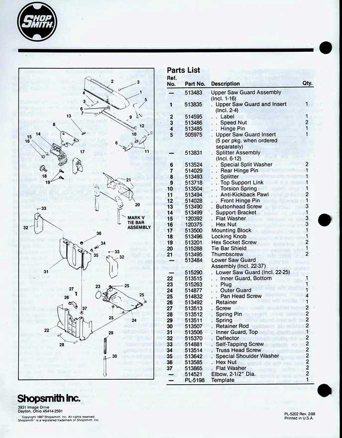

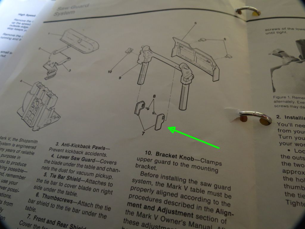

Ed I have the original Instructions for my "Mark V (Model 500) Saw Guard System Retrofit Kit 505875." (PL_5202 Rev. 2/88)There aren't any Shields on the drawing or referred to in the directions. Maybe they changed it later, but those shields were not part of the original kit I bough 1-30-1991 according to the invoice. By extending the quill, and closing the bottom gap, that has done more to improve dust collection than anything else I have tried.
Instruction parts breakdown that came with this UPDATE
Guard sheet-reducd.jpg (634.02 KiB) Viewed 2291 times
It looks like part #32 would do the same function. Those I'm guessing you do have in place.
I guess what matters most is if it is working for you. With the blade that far over does the upper guard still function?

reible wrote:It looks like part #32 would do the same function. Those I'm guessing you do have in place.

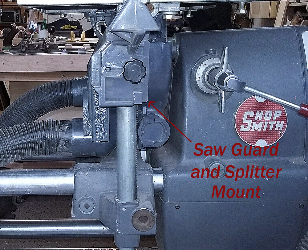

Ed, Item 32 is a thin plastic strip that moves up and down in a slot on the headastock mounted portion, but the biggest gap is to the side of them, as far as the splitter, it is adjustable and is near its limit at that position, here is a picture of that.
Splitter mount
Splitter mount
Saw Guard mount.jpg (1.01 MiB) Viewed 2272 times
Item 32.jpg (457.65 KiB) Viewed 2272 times
Actually I used this for years and never thought much of how poorly this dust chute worked, but recently I had to do alot of ripping on the Shopsmith and after using my Saw Stop for my main table saw with its 90% collection, then doing so much ripping on the SS I ended up ankle deep in saw dust and then started questioning why it performed so bad. Believe me I love my Shopsmith, after all I still have it 35 years later, that is why I just bought the Power Pro Do It Yourself Upgrade and just scored a 520 upgrade, never used on eBay for half price, so now a whole new learning experience, plus next week I am going to look at a 1957 Greenie, to update with the parts off my 1981 SS after the Power Pro conversion. And now all my inserts, 6 of them won't fit my new 520 table, etc, so eBay here they come.
