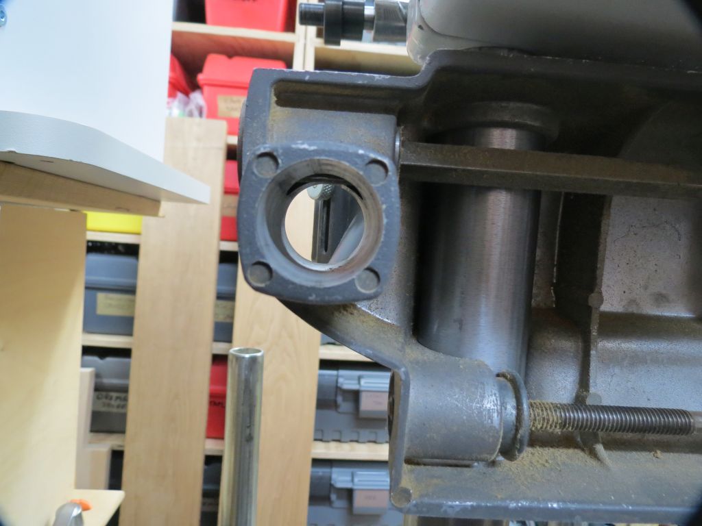

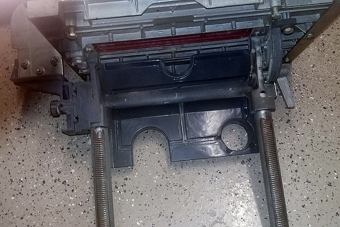

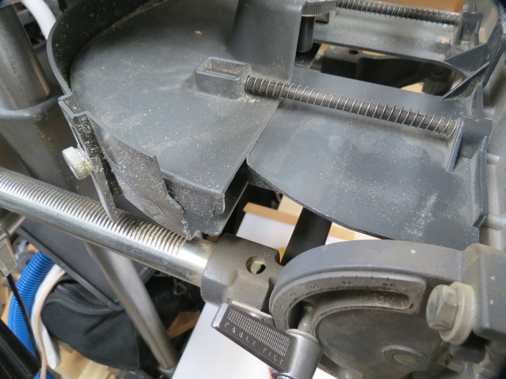

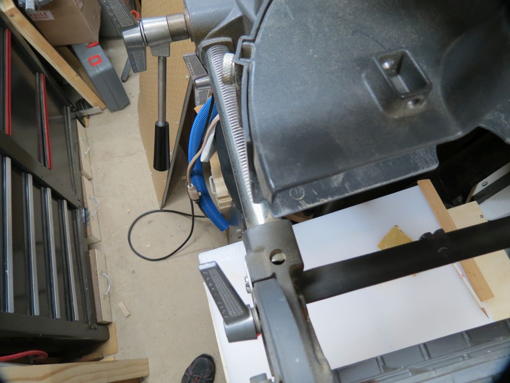

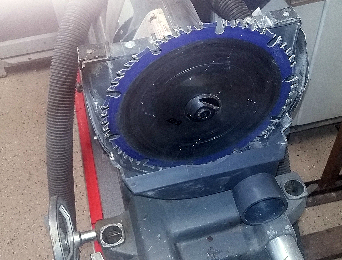

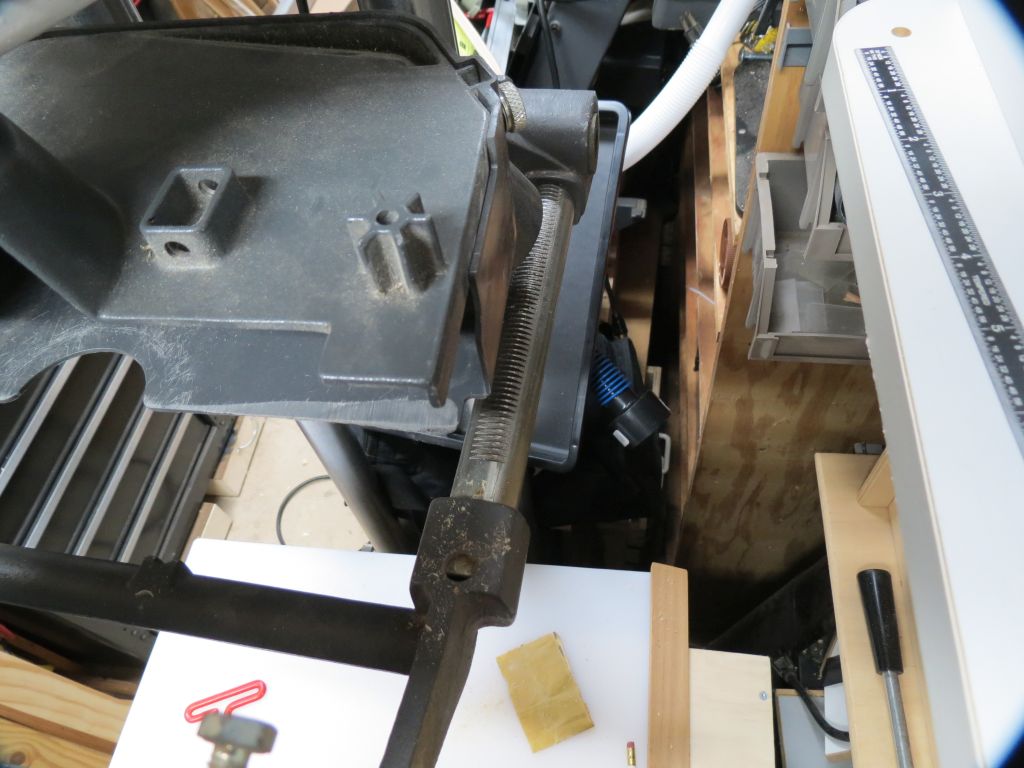

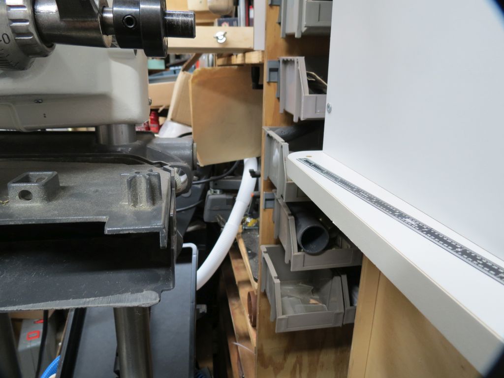

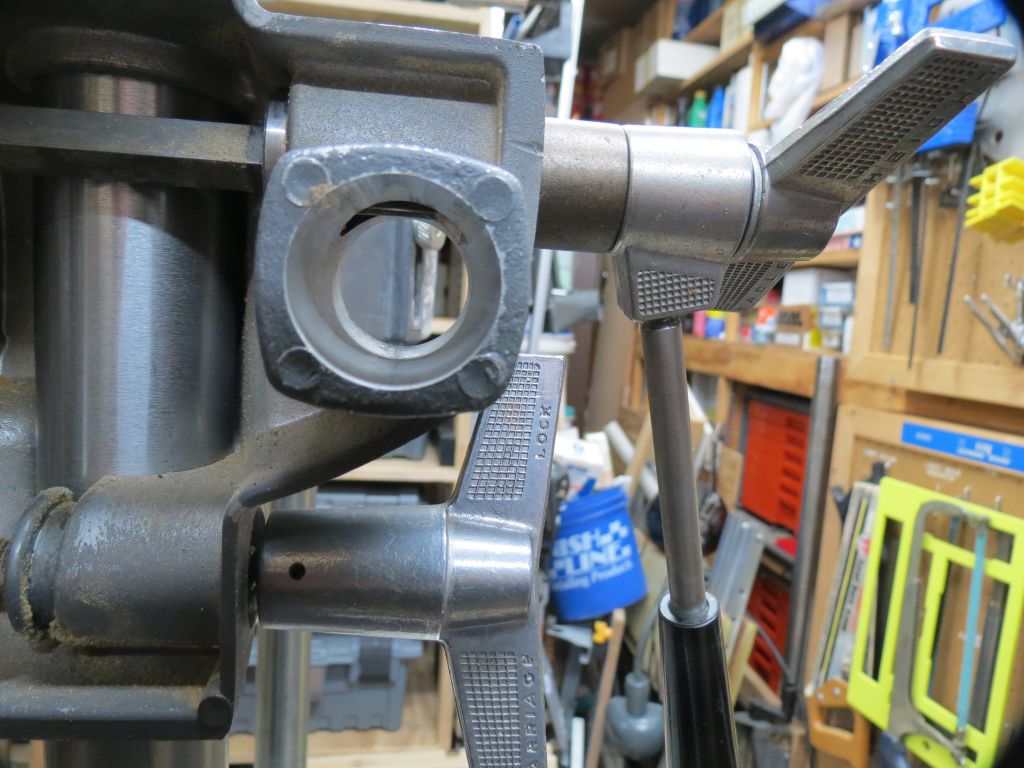

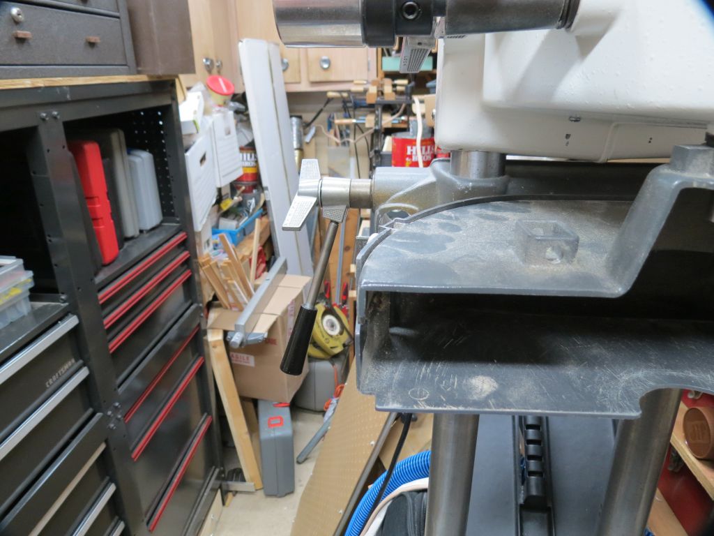

Now to some pictures to help understand this 500 vs 510/520 saw guard and 500 dust chute thing. I have a few pictures which I hope shows how things interfere, I'm not going to comment on them but if you have questions please ask. The first couple are of the 520 guard and then the 500 dust chute after that.
Now we are moving to the dust chute

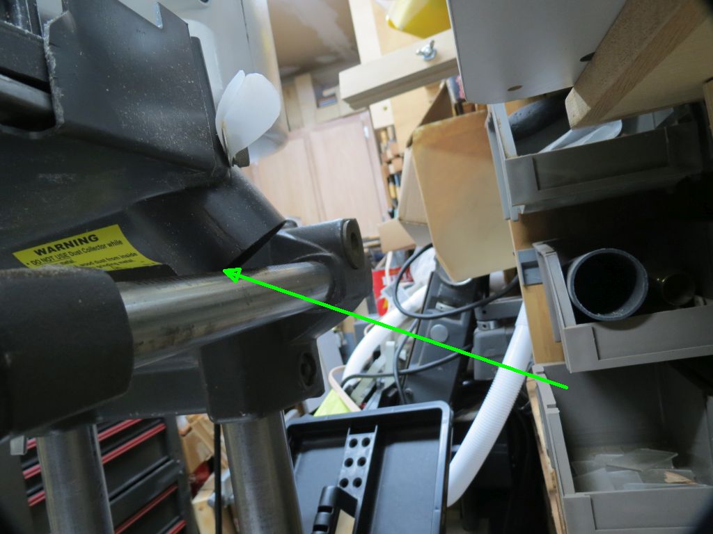

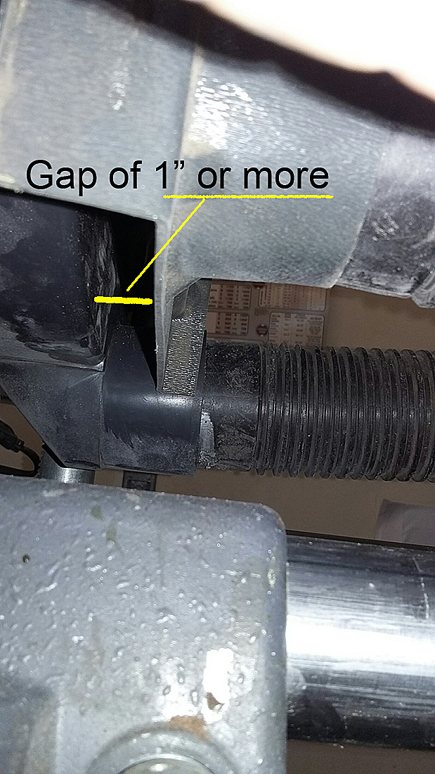

evidentially when I posted earlier, my copy paste held on to a different page other than the one I wanted. Above is the correct page. The problem is the portion of the guard farthest from the Head Stock is far enough away as ti leave LARGE gaps, thus poor chip and dust collection.See pictures.
This is the half of the chute that attaches to the Headstock
Portion that attaches to Headstock.jpg (1.08 MiB) Viewed 1801 times
Portion that attaches to table tubes.jpg (922.93 KiB) Viewed 1801 times
Gap between halves.jpg (625.64 KiB) Viewed 1801 times

Ok, so you do NOT have the 500 dust chute posted earlier.
https://www.shopsmith.com/ss_forum/view ... 61#p207961
Therefore all the 505-520 posts/threads are of minimal value to you.
I agree that the huge gap between the bottom of the two 'halves' is puzzling.
Afraid you are the pioneer on this. ;)
