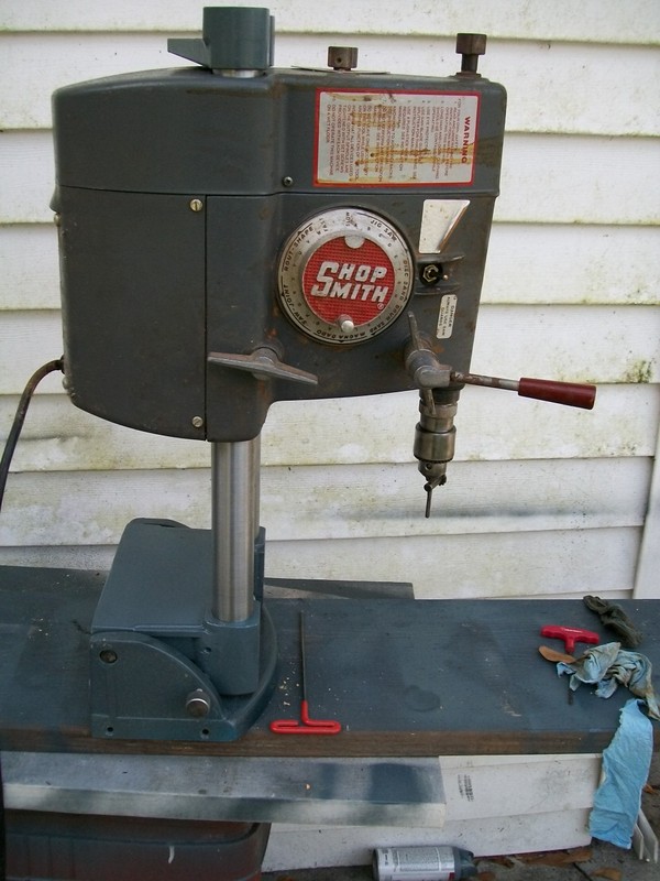

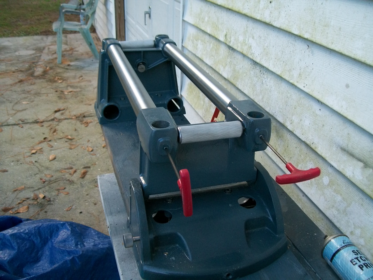

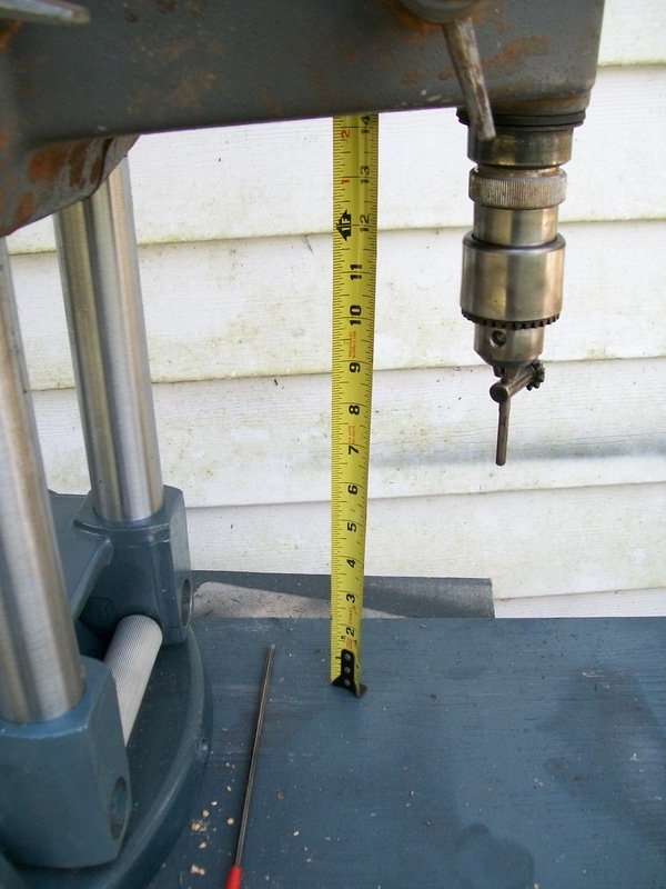

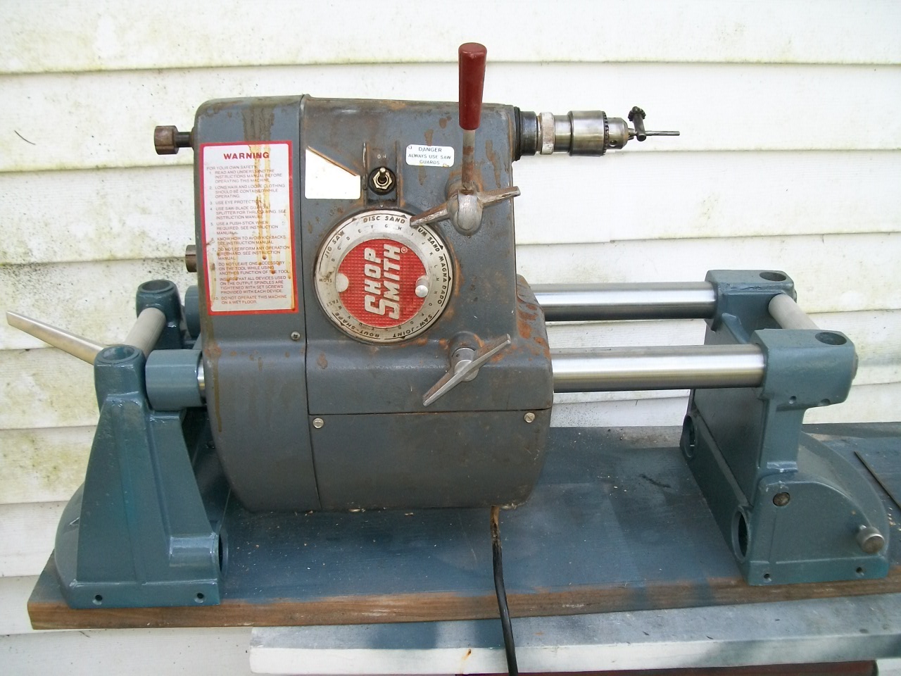

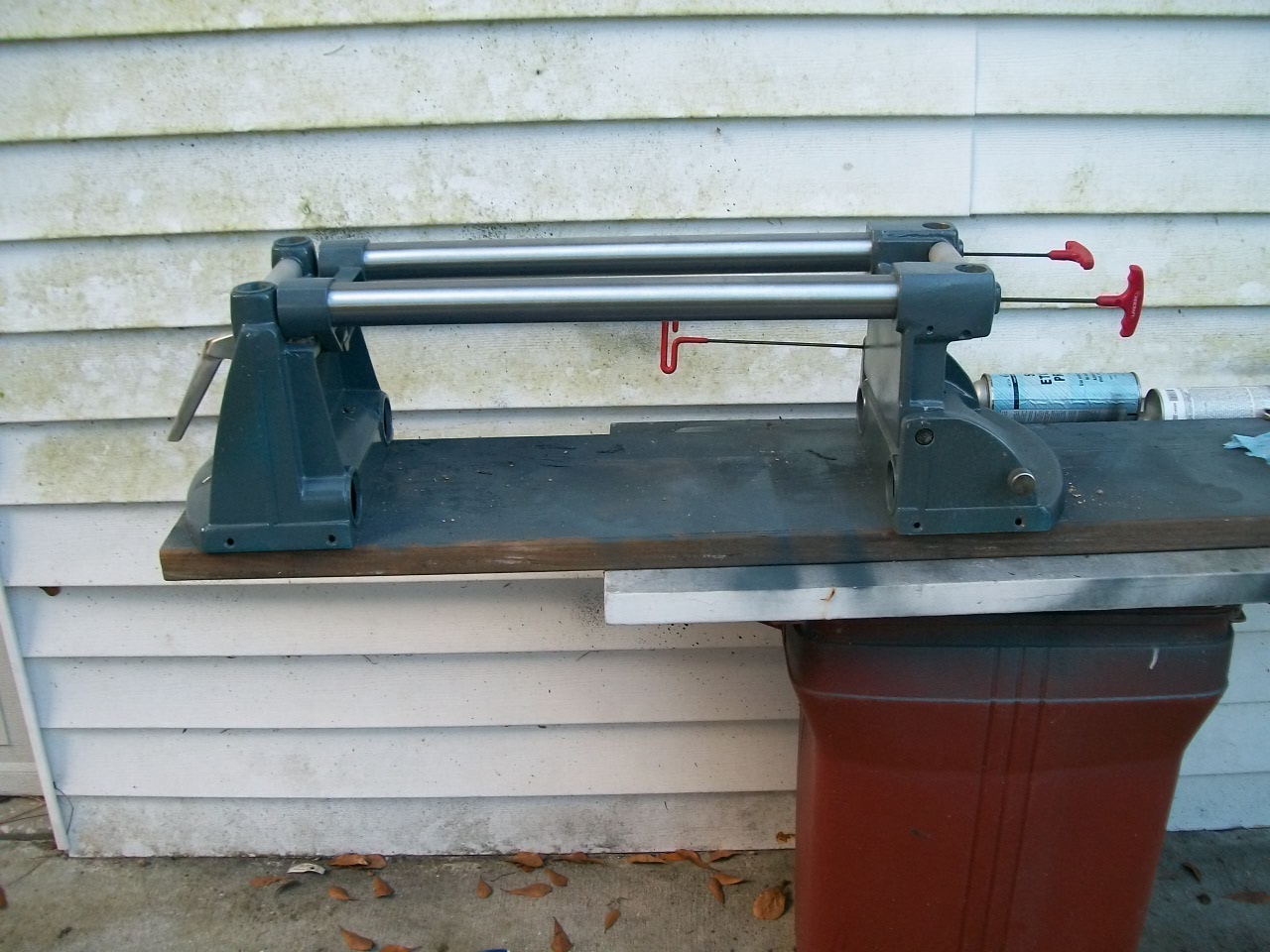

squashfest81 wrote:Looks like a great space saving solution. How short, 18 off?
I cut off only 16" and I sometimes wish it had been only 14". Changing modes of operation (vertical to horizontal) produces interference. I then have to go back and relocate or remove items to allow transition. Normally taking off the chuck is all that is needed.

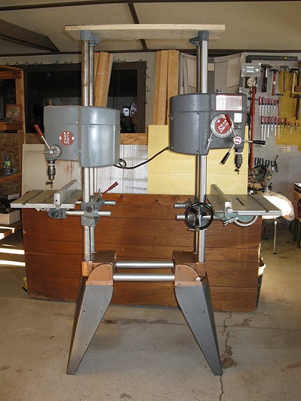

I remain completely happy with my "Push-me Pull-me" (Dr. Doolittle reference) drill-press for drilling and all other vertical mode uses. This is an old picture, it now sits on a SS caster set. I have been pleasantly surprised at how stable it is when moving it around. I was a little curious when planning it about stability but it is fine.
I do need to finish my shorty and paint it.
I might even shorten another one.
I love the Shopsmith flexibility... :cool:
