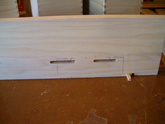

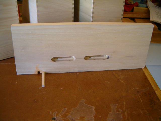

Here's a 14" long, 1/4" finger joint made with a homemade fence and tapping sideways with a hammer. Took 4 or 5 samples before it was right. First too wide fingers then too narrow, then a light tap finally got it right.

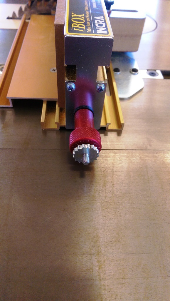

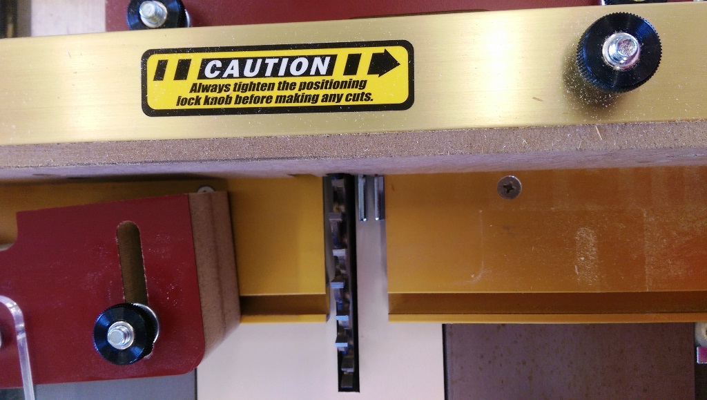

There are actually two adjustments. The two silver bars in the first picture are what the cut slot fits over. The red knob changes the width of those bars to make a tight fit in the cut slot. At the same time it moves the pair of bars in relation to the blade proportionally depending on the bars width. This sets the pin width.
So far I have seen the pin width start out a little too wide so I need to recheck my calibration. That is not a real problem since the pin width is adjustable independently of the silver bar width. The silver knob adjusts the two silver bars in unison closer or farther away from the blade thus changing the pin width without changing the silver bar fit in the cut slot. The white marks on the red knob are 0.001" marks. The black knob on top locks all the adjustments. The gold try in front slides side to side and once the adjustments are made you slide it tight against the outside silver bar and lock it down.
So in this case we are cutting 1/4" slots but the pins have to be slightly less than 1/4" depending on the tightness you want. As a result each set (pin/slot) is slightly less than 1/2" and the effect is cumulative.
- IMAG0437.jpg (194.7 KiB) Viewed 7619 times
- IMAG0438.jpg (188.12 KiB) Viewed 7619 times

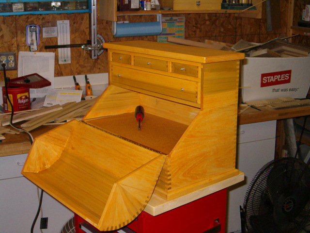

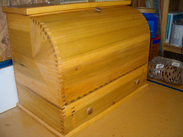

Now Ive changed my mind about getting one of these boxes. I love to KIS (keep it simple) with woodworking. Gotta show you my simple jig that works wonderfully well with a couple of hammer taps. And it only cost about a buck. Here is a chest made with that jig
- Back of Jig.jpg (123.78 KiB) Viewed 7503 times
- Front of jig.jpg (117.93 KiB) Viewed 7503 times
- chest with box joints.jpg (127.33 KiB) Viewed 7503 times
