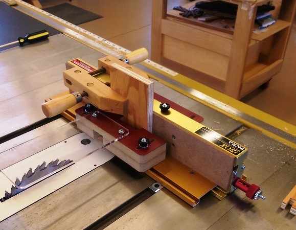

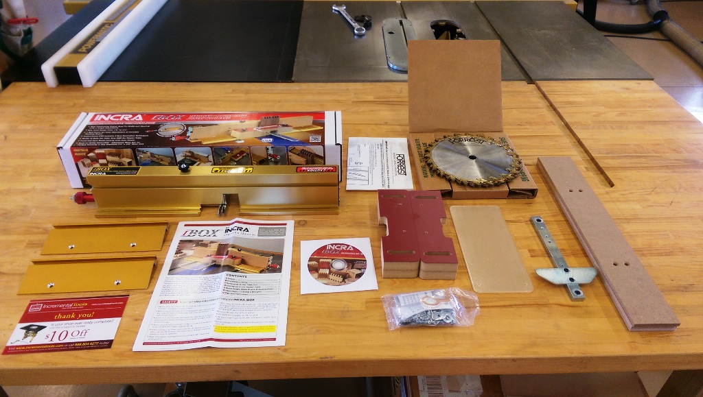

I finally sprung for an Incra I-Box jig. They had an email special with an extra $25 off plus their already $42 off the retail price for the combo with the Forrest 1/4 and 3/8 box joint blades. I made a spline jig a while ago but had not bought a flat tooth grind blade to use with it so this was a perfect time to kill two birds with one stone. Checking around I could not find a cheaper price buying the jig and the blades separately.
I ordered it on 10 May, it shipped on 12 May and I got it on 17 May via UPS. I put it together yesterday in about 30 minutes with absolutely no issues.

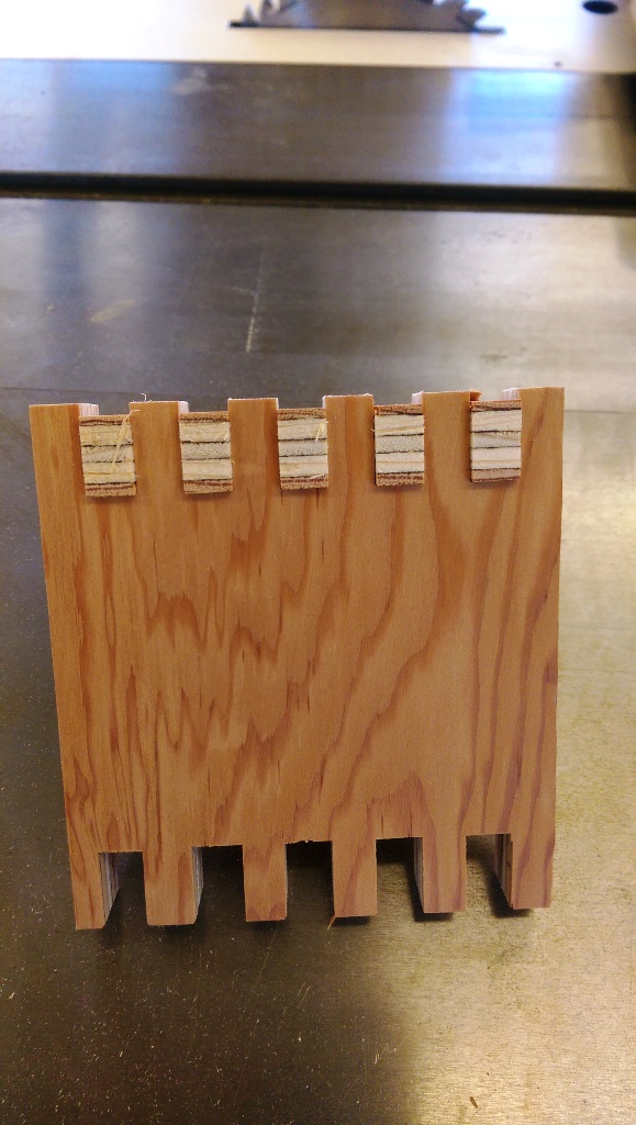

Today I went out to make some saw dust. The first attempt was close but the pins were just under 1/128 too wide. I re-calibrated and it was much better but the fit was very tight (the first joint picture). Hmm...now what? There was not anything about this problem in the calibration/set up instructions. I thought the manual must address this. On the last page (which I had not read) there it was. How to adjust for pins too wide. A quick tweak and a perfect fit (second joint picture). Had I looked at first the problem would have been solved immediately.
The blade is set too high. That is why the pins protrude so far through. Not a problem since this was just a test.
The Forrest blades are superb as expected. Absolutely perfectly flat bottoms and NO tear out as the pictures show. I set up the blades for a 3/8 grove and according to my fractional caliper it is dead on.
The jig is fully adjustable for any size box joints up to a full stacked dado. The quality is second to none as those that have Incra products know.
There are instructions for use on a table saw and a router table and they make a version for the SS miter bar.
The I-Box is top notch and performs as advertised. Oh, that is my opinion. Others may have a different opinion. :) :D

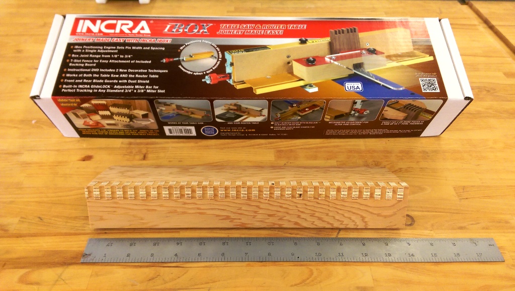

Here's a challenge for your new jig, John.
Can you make a 1/4" box joint that fits well and is 14 inches long?
I ask this because I'd like to see if it is as accurate as my method of tapping a homemade jig with a hammer.
If your jig will let you produce a 14" long box joint, I will buy one and also sing it's praises.
By the way - I always plan for, and saw my box joint fingers long! That allows me to sand off the protrusions flush.

I don't know but I will try. :)
Posts: 6584
Re: Incra I-Box Jig
charlese wrote:Here's a challenge for your new jig, John.
I guess nothing needs to be said. :D :D :D
Re: Incra I-Box Jig
Worth a thousand words!!!
Posts: 3812
Re: Incra I-Box Jig
It speaks for itself. :cool:
Re: Incra I-Box Jig
So shopsmith should be seeing an order soon?
