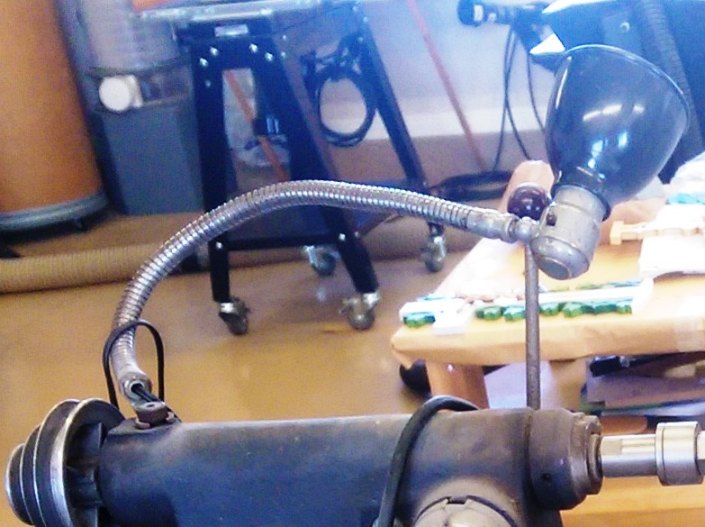

Hi, I'm new here and I have a VERY old unit that was given to me. All the goodies as well. It works great and it does things that I don't have other tools that can do.
Anyway, it has a "Magna" work light that was attached to the motor unit and the base is broken. It's kind of a quick detach thing that reminds you of an air chuck sort of..... Three ball bearings are released when you pick up on the outer ring. The light is great but the base has broken. The plastic piece that sticks up from the motor mount broke off. Is there anything still available to replace that thing or to adapt it to the new style multi mount? I'm sure I can fashion something but that's just another project in a long list of projects.

Picture of the base and broken part
Thanks

Interesting, I have never seen one like that. Can you post a picture of the light so we can see what it looks like?
Re: Old Shopsmith Magna Light base
Looks like a turning project. From what I can see this looks to be reasonably simple to put on the lathe and make out of nylon or similar plastic.
I've not see this type of connect on any current shopsmith hardware so it unlikely you will find it unless someone here has a spare.

As Ed said it doesn't look like anything SS but who knows. You said Magna. Does that mean a model 10 or the MK 5s made by Magna? The only light I have seen for the model 10 was made by Vimco and it had the SS logo on it.
