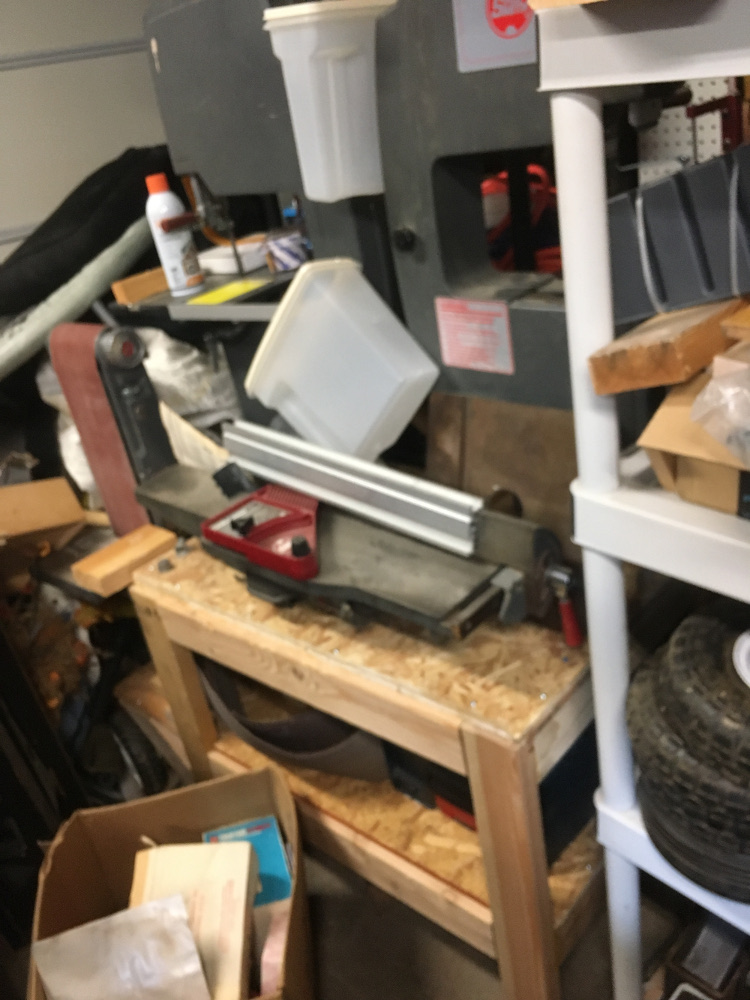

Hey Gene,
I apologize for the messy and bad picture. My cousin still has his crap everywhere so I am still unable to get to most things. :mad: :mad: :mad: so I reached over as close as I could get to take this BAD picture its of the cart i made for the 2 bandsaws, jointer and belt sander (actually the belt sander extension was an afterthought, that's why it is so much lower [no room on the main table]). The table height is a few inches shorter than the height to mount the SPT on the SS. I would guess that it could be a bit higher to aid making the transfer, but if it seems to be or does become a problem I'll make adjustments to the table bottom (adding leg length and bigger casters)
For the SPT legs, I just drilled pieces of 2x4, gluing them to the table surface rather than trying to precisely measure for the space between holes. I also figured that drilling holes in the table top would make the SPTs too difficult for me to get out (rather than using the blocks to build up the holder). I did end up putting a small block under one end of the jointer to keep it more stable. The far end has a grab handle (about where the table on the band saw is) so I can move the cart more easily.
spt tbl.jpg (203.14 KiB) Viewed 5622 times

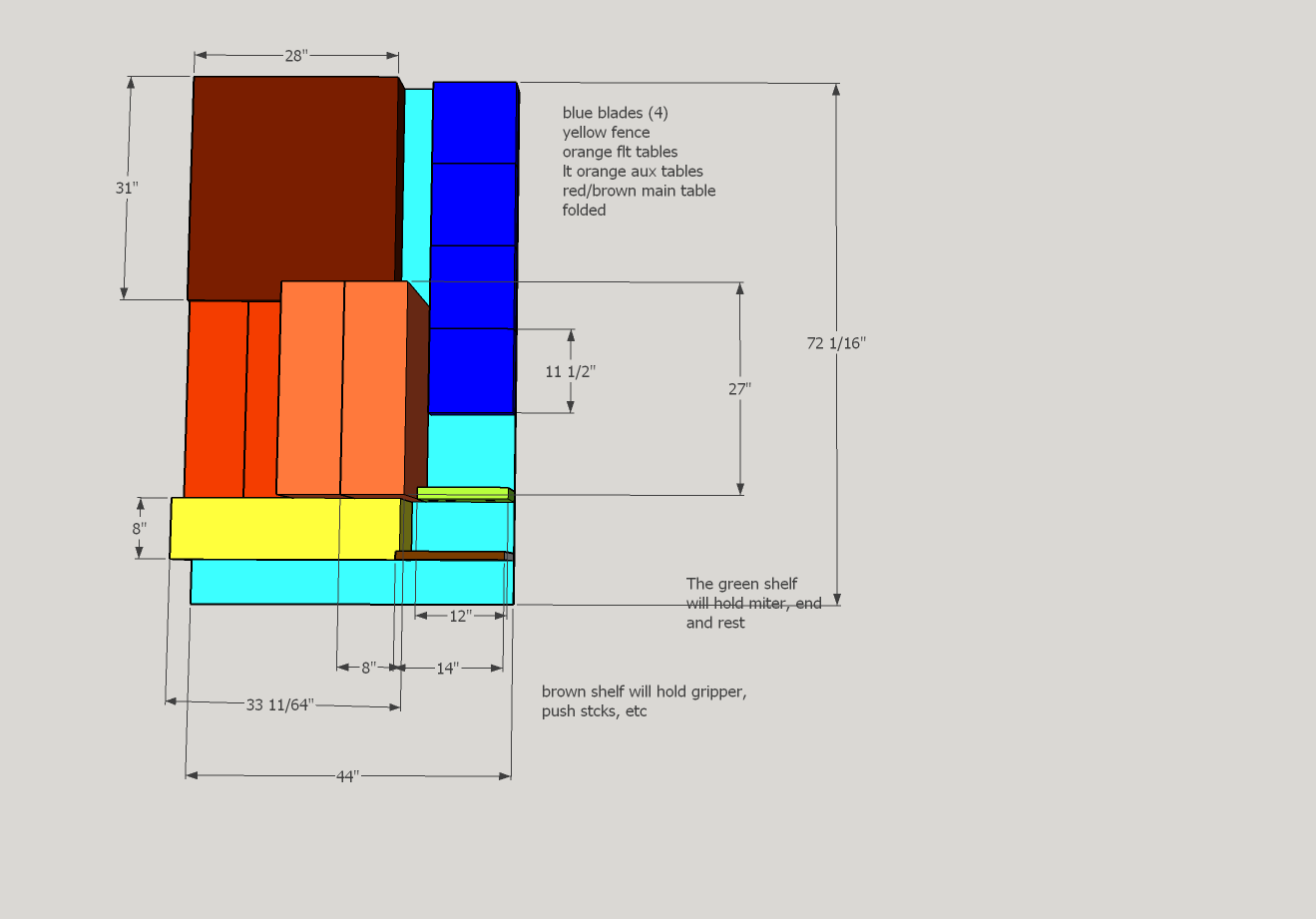

Because you wrote about holding an extra main and aux table ....
my next step (after I finally get some place to move around) is to make a horizontal storage area [moveable wall] (about 45" by 7') on casters to hold all the basic SS items on one side (tables, fence, blades, miter gauge, etc), with less used things on the other side. I made a quick Sketchup drawing using rectangular blocks the approximate size of each piece to aid in layout. Where I think it is convenient plus how often or not I'll use the piece (that is also the reason to have the back side available for less used pieces). I plan to remove the 2x8 attached to the front of the SS where most of it now sets. I think it will be easier to bring that wall over to the SS when I need it rather than crowd all those pieces in front on the storage 2x8 or walk over to the side storage and back each time. But then again maybe I'm just being WAY too lazy! :D :p
ss parts holder.jpg.png (36.6 KiB) Viewed 5622 times
Just my thoughts. I'm certain you will design something perfect for your needs.
