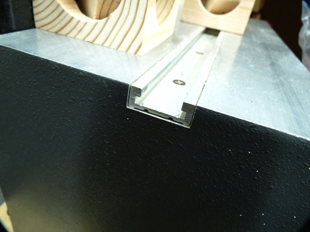

FYI adjustable track picture

reible wrote:FYI adjustable track picture
Are your screws "snug" or "loose"? Both of my current t-slot extrusions are the same.
Re: RE: Re: Bandsaw Fence & Miter Gauge
The track is not loose. A screw every couple of inches and the track does not move or feel loose at all. The screws are not tightened down but a firm snug if you will. If you tighten too much I guess you could permanently deflect the track and get it too tight???? I just do it enough to get the wobble out of the bar but still have it slide smoothly. Good to wax and polish both parts.
Thank you, Ed. The track is truly adjustable. I can screw it down to the point that the miter gauge will not move. I can also tighten the screws only to the point where the side-to-side movement is gone. It is sort of a tricky balance but it works.
If this is a patented procedure, I wonder why Shopsmith does not advertise it. Too bad it is not a feature of all the miter track Shopsmith produces.
