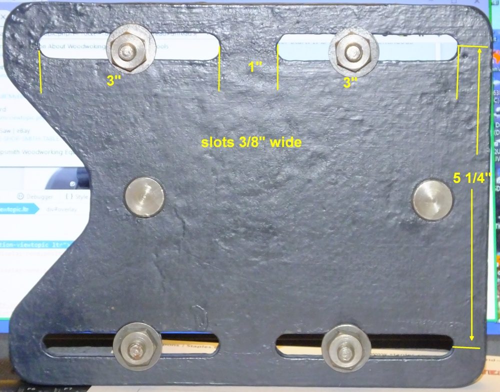

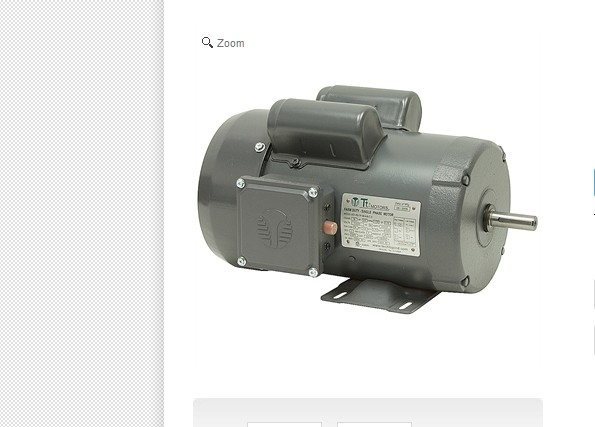

I did have a section on motors in school it was a lot of years ago and not something that came up when I worked so most of that is gone. I know a few things about the motor, I'd like 1/2 hp, needs to have a 5/8" shaft, rpm 1725, I'd like it to be reversible and run off 120v. In addition since I don't want to make changes to the bench I'd like the cap to be located other then on top.
With that in mind I found a capacitor start and run motor, should be better then just a capacitor start. It is "Farm Duty" continuous duty, ball bearings, TEFC, thermal overload manual reset.
Base 4 slots on 3" to 4-3/4" x 3" centers, right now I don't have access to measure the plate on the 10ER so I don't know if it will fit. See image below for what the plate looks like.
The other issue is the dual capacitors. They are off to the sides but I don't know if they will get in the way or not. It looks like this:
The over all size is listed as 12" x 8-7/8" x 8" no idea how they measure it for the last two dimensions.
We are talking $120 + shipping(it is new surplus).
See any flaws other then the unknowns I have?

I don't think it will work. The slots on the motor bracket are 5 1/4" on center. The height if the AO Smith 1/2HP motor is about 6 1/2" from the mounting bracket. The motor installed with the speed changer clears the bench by about 1 1/4".
Your motor dimensions of 8" and 8 7/8" I would guess are the height from the base to the top of the capacitors and the width through the overload box. From the picture I would guess the height to the top of the capacitors is the 8 7/8" dimension but either way it is too big to clear the bench and too small to bolt to the 10ER motor bracket.
10E-ER motor mount plate dimensions.jpg (532.55 KiB) Viewed 8895 times
