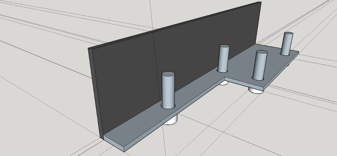

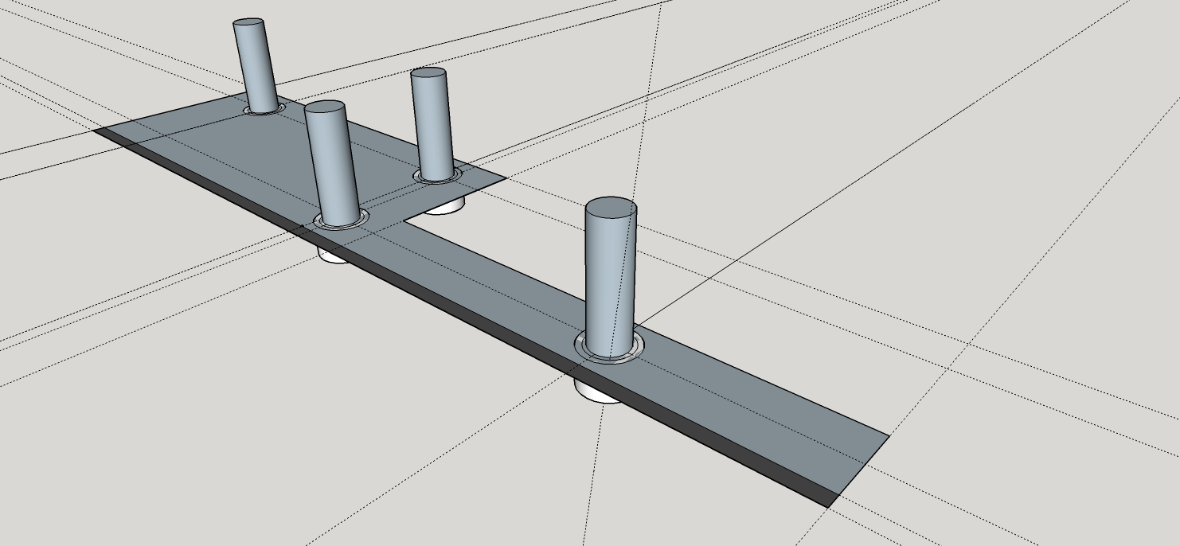

To proof your drawing, I built the whole thing in Sketchup. I had doubts when I started because I did not see clearance for the bolt heads or nuts.
Note: Drawing depicts four Cap Head bolts which is not the required hardware and the bolts are not properly oriented. Reference the photo image contained in the thread. Verify clearance and orientation was the purpose of these drawings.
Well done. Excellent job.
