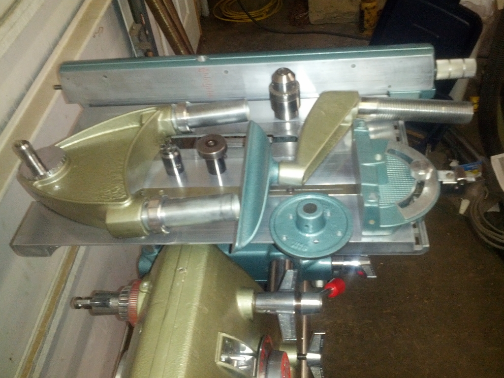

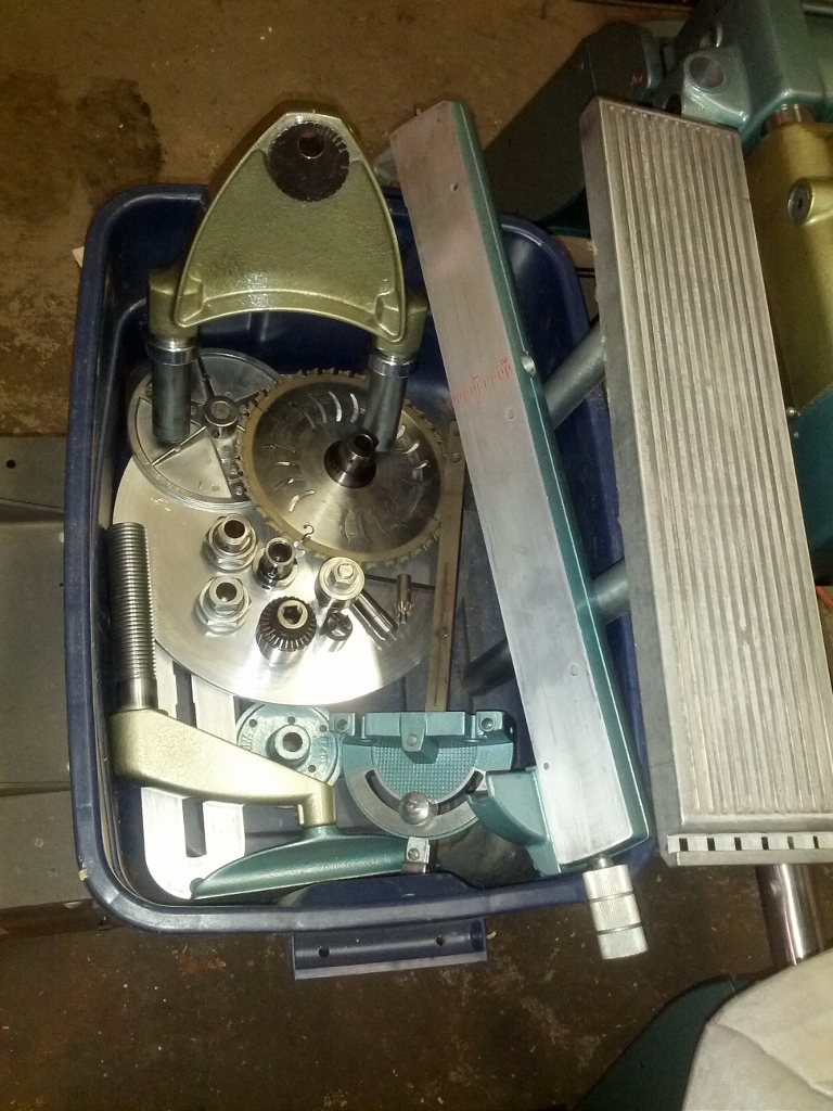

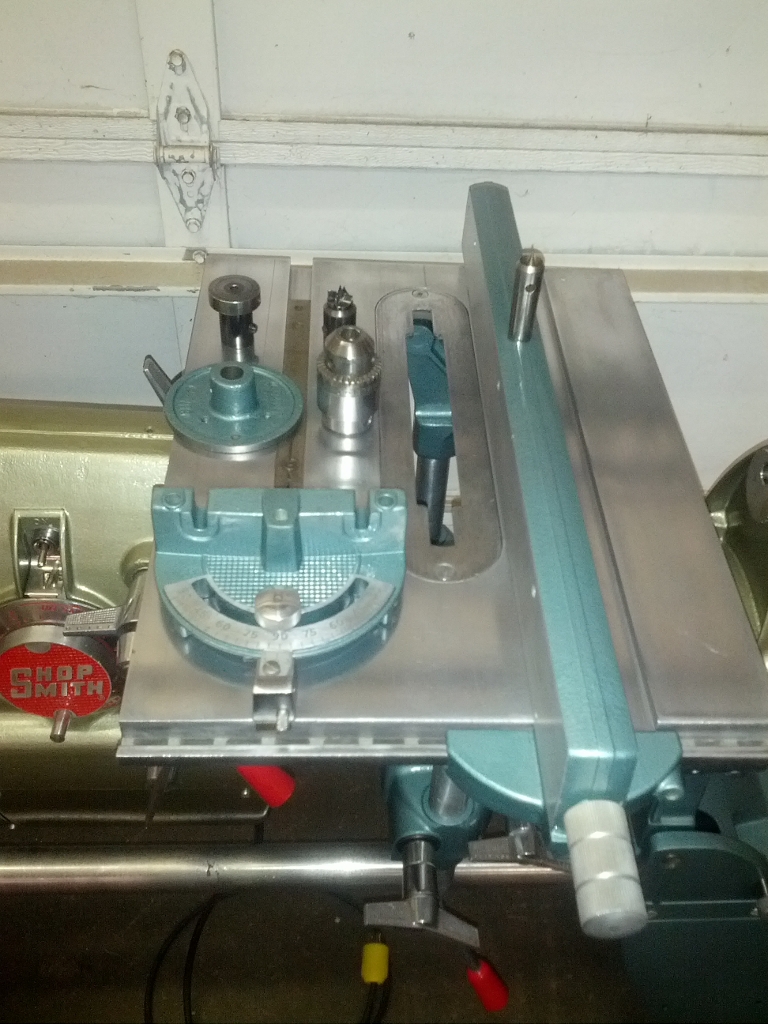

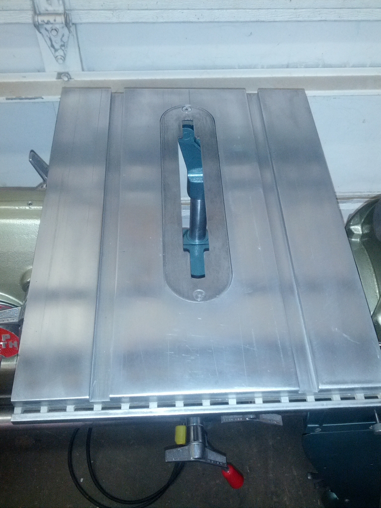

More pictures of the table and accessories cleaned up. Price at purchase was $289.50 with easy terms 1954.
