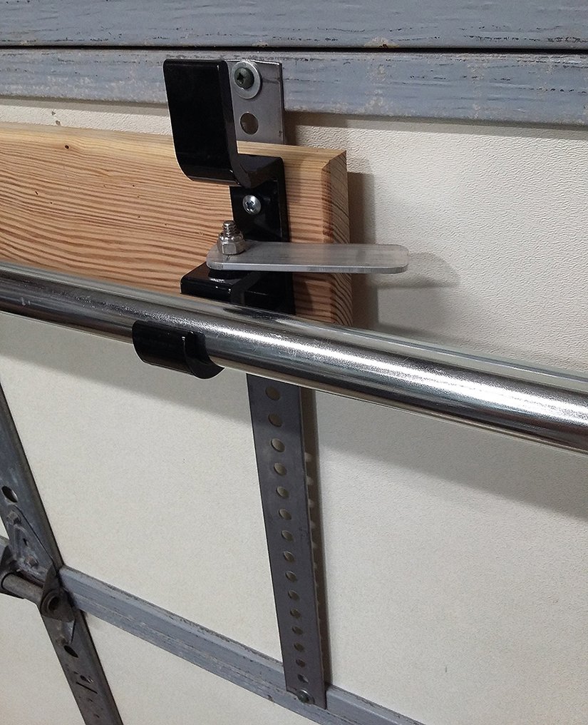

I ordered the Shopsmith Table Storage System because I wanted an easy way to store the tables, etc. when not in use, I did so on faith, because there isn't a lot of pictures and information on how to use the system. After it arrived I thought that is a lot of money for what you get, but I figured as it is American made, I am willing to pay a little more. Even so it is a bit over priced. My original plan was to use the one last un-used space, the inside of the garage door. Here are the modifications and set up, it works great. To attach the system to the door, I used heavy duty perforated strap, screwed to the door frame.
The flippers to retain the tube automatically swing down into position if you forget to turn them over the tubes, as soon as the door starts up, their own weight swings them into place

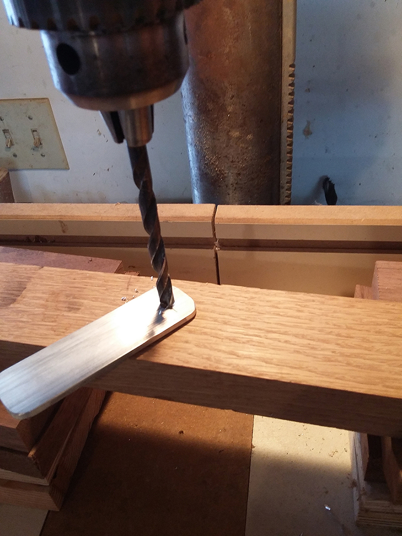

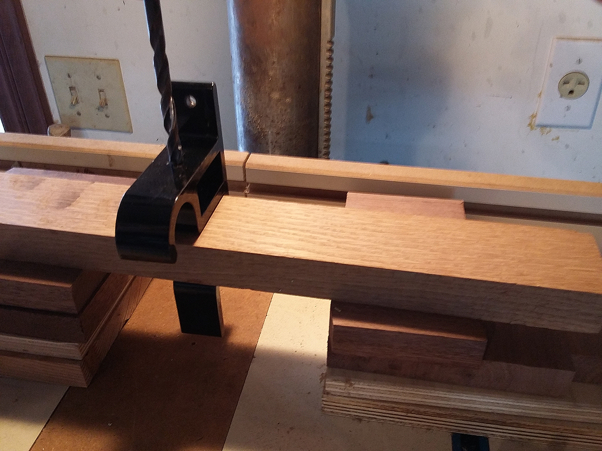

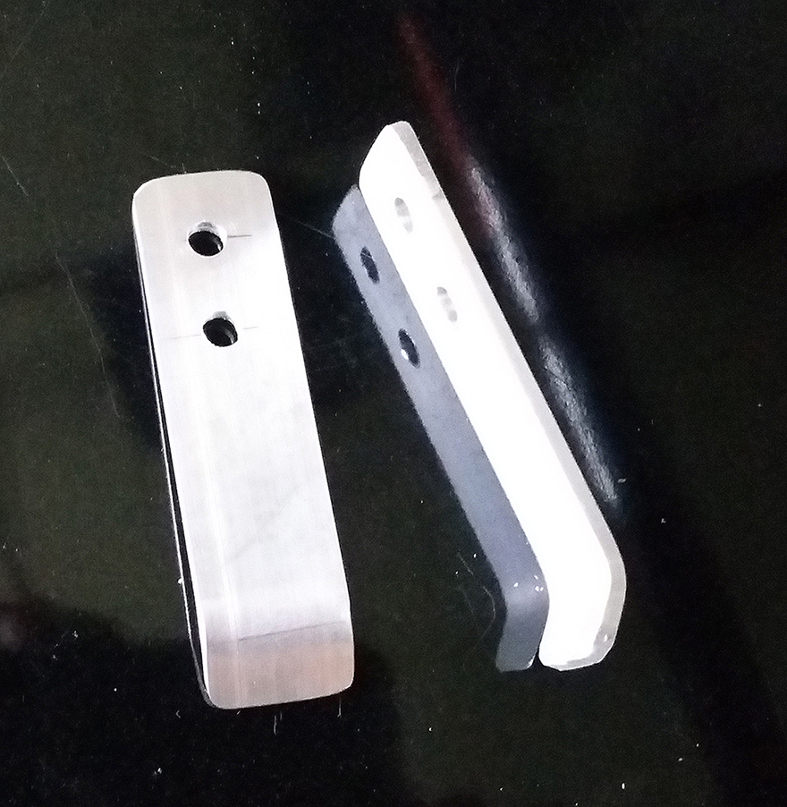

Drilling Bracket for retainer flipper
Modif Brkt.jpg (868.71 KiB) Viewed 5741 times
Drilling Flipper to retain the tube holding the tables.

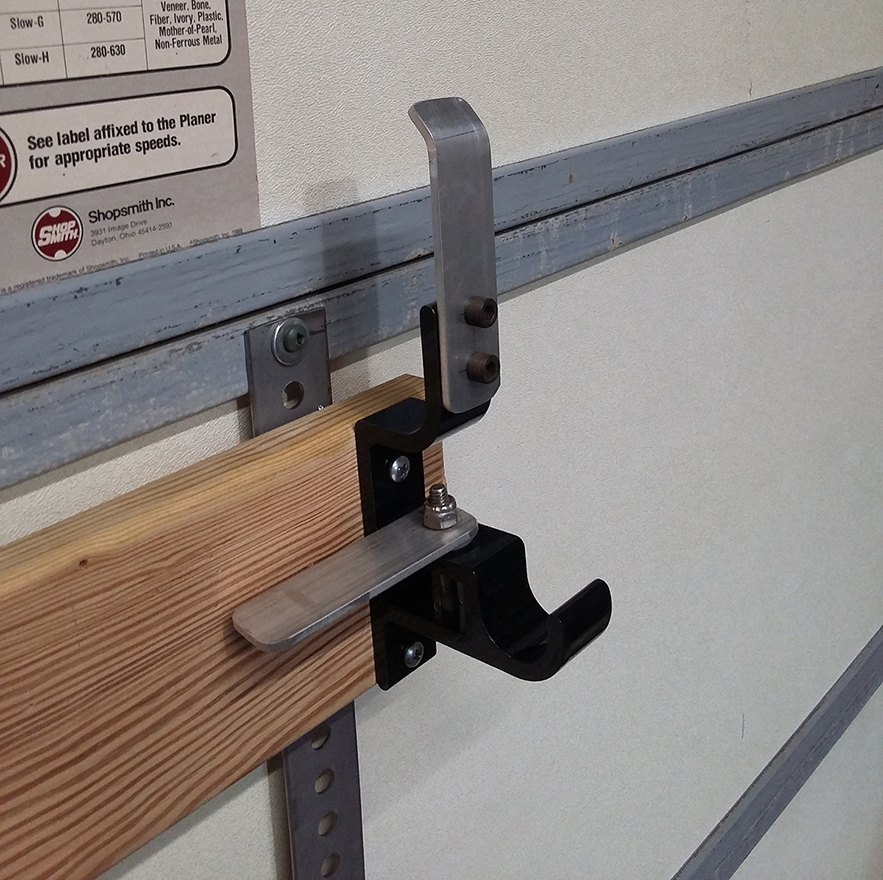

Brackets to hold extra tubes.
tube retrainers.jpg (548.01 KiB) Viewed 5741 times
Bracket installed
Bracket installed

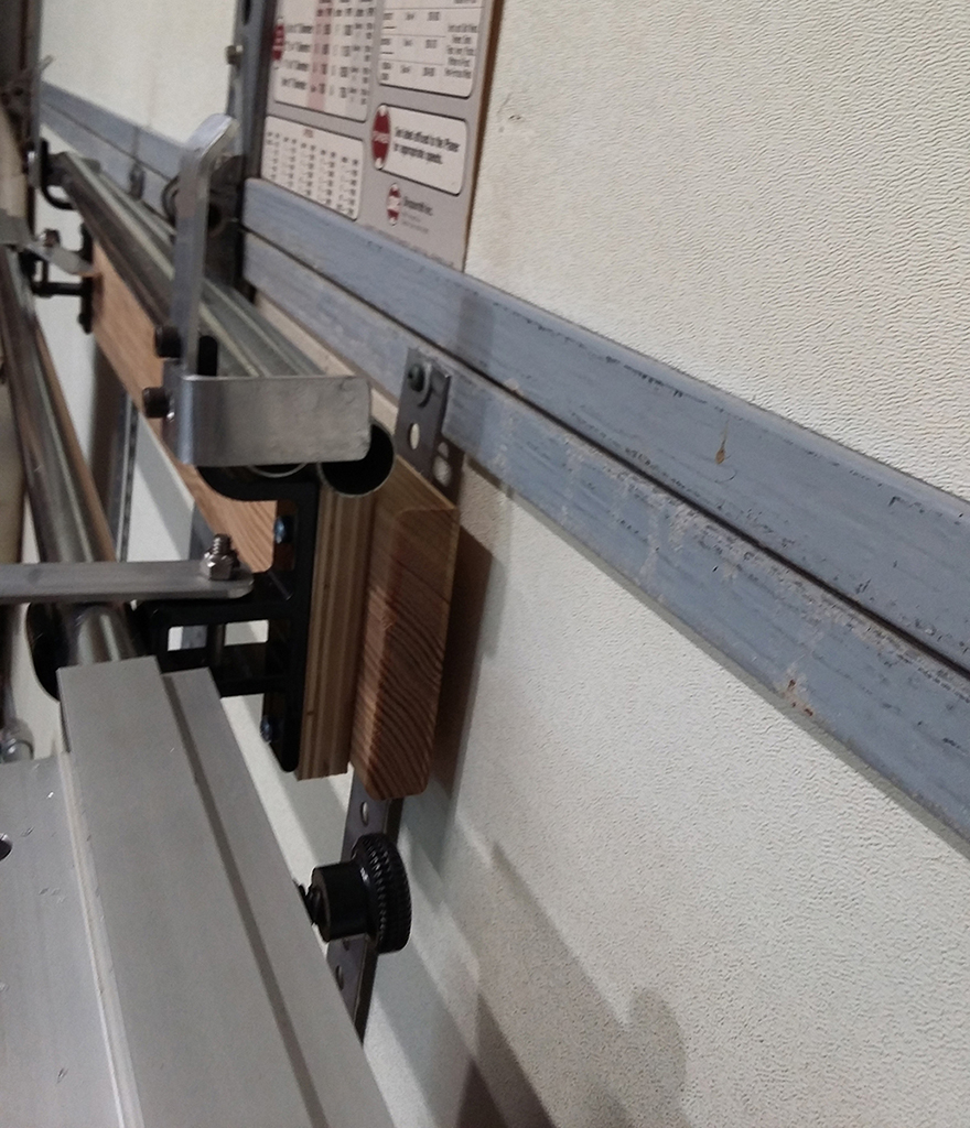

The flipper is out of the way in this picture to allow the tube to be removed.
out of thge way.jpg (660.18 KiB) Viewed 5741 times

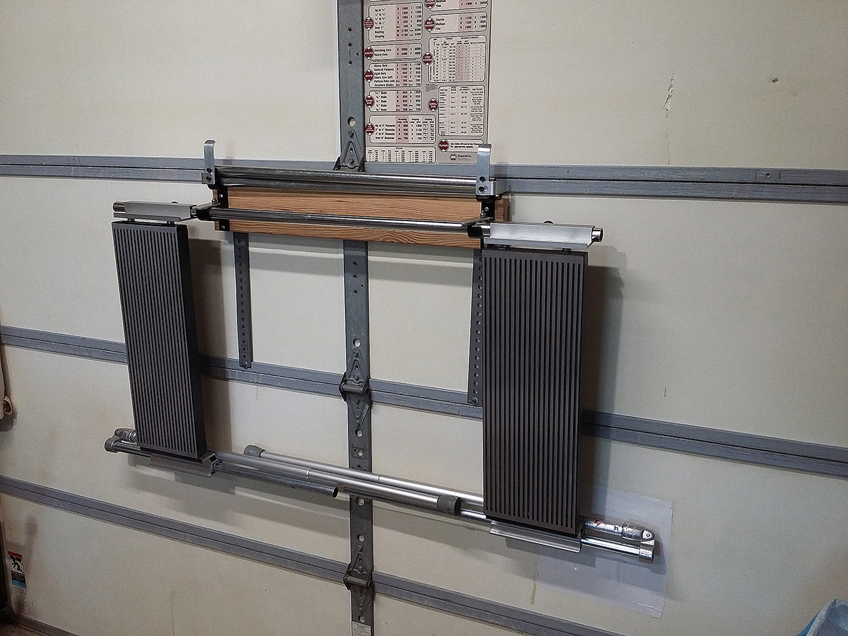

I had to add spacers so that the Tube Retainers would clear the door as it opens.
Completed, attached and ready for use. Dead space utilized.
installed complete.jpg (905.85 KiB) Viewed 5741 times

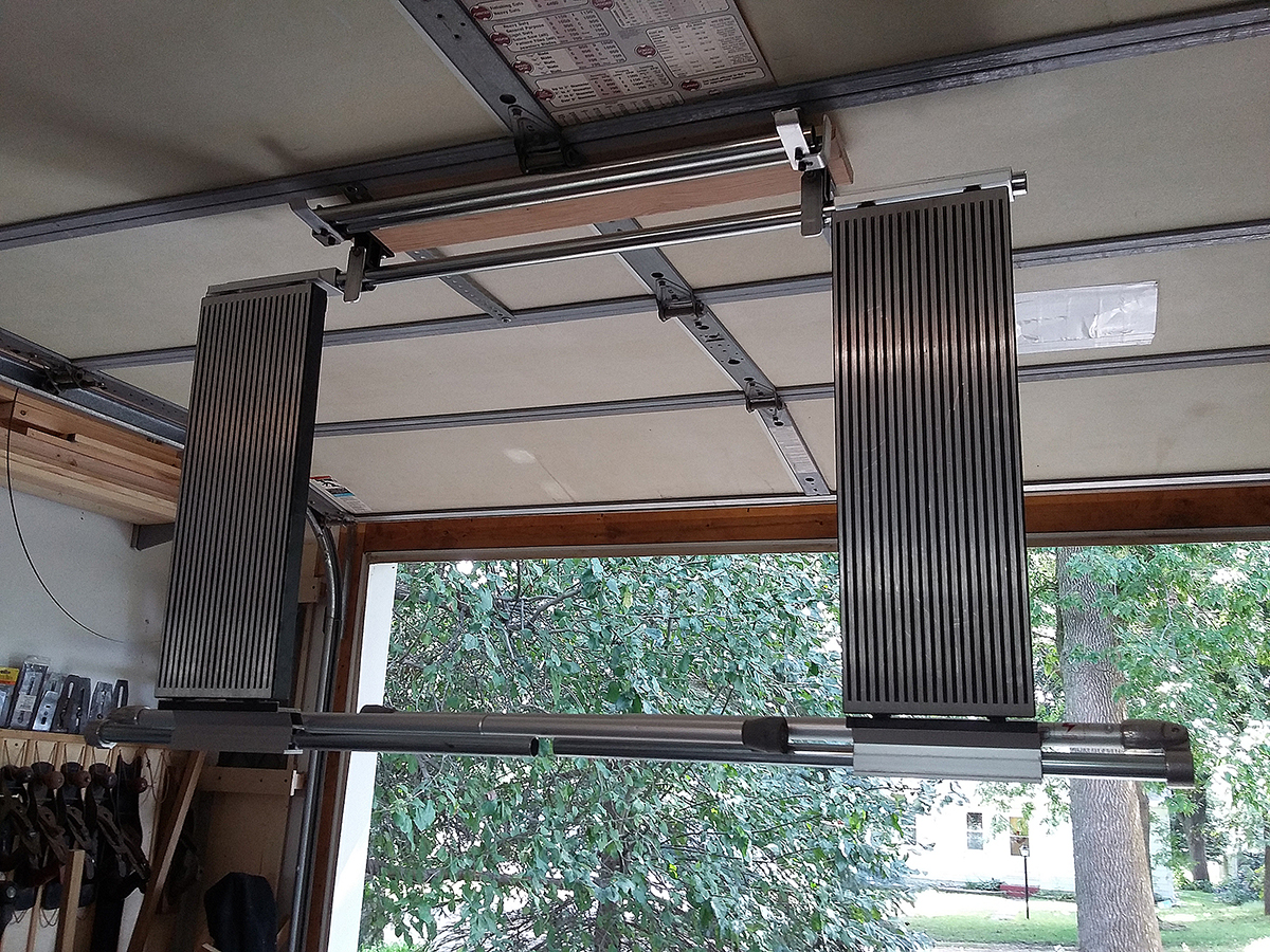

With the door open I can walk under the tables hanging from the Bracket
door open.jpg (1.15 MiB) Viewed 5741 times
