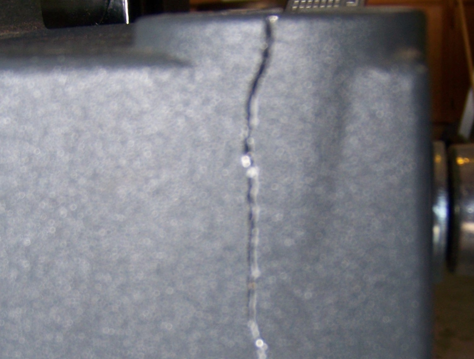

I have a Mark 7 which is just now 2 years old. The Carriage is cracked on the front side where the Table Support Tubes fit.
- 102_2557 (3).JPG (320.36 KiB) Viewed 9883 times

I would immediately contact the mothership. They should take care of you ....

Keep us posted. Customer service is second to none.
Do you know how it happened?

I was getting ready to turn some pens using the Universal tool rest when I noticed the crack. The last thing I had done that required the table was the drill press to prep the pen blanks a couple of weeks ago.
Re: Mark 7 Cracked Carriage
Is it possible that you tightened the hold down bolts too much when you last used the Universal Tool rest?

WoW! Has anyone ever seen this? I can't imagine how that could occur. SS carriages have been around for almost for ever
I expect the MS will make you whole.

The Universal Tool Rest does not put any pressure on that area.
- Posts: 35598
brown50 wrote:The Universal Tool Rest does not put any pressure on that area.
What area does it place under stress?
It clamps to the saddle between the rails.
