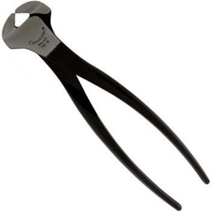

Jmolten, it just dawned on me that I might know of a low-cost, low-tech solution to your cut-nail problem. I did a mantel project from an old reclaimed heart-pine beam myself a few years ago, as documented in this thread. I think I paid $300 for the beam, de-nailed and resawn. I had forgotten all about the de-nailing. I was going to help the seller with that chore, but I was working long hours during the week, and he was coaching basketball or something on the weekends, and so our free time never coincided. He wound up doing it without me.
But I do remember him describing the de-nailing process, as he had learned it from an older guy. The secret sauce was to use a small drill bit, maybe 1/16" or so, and drill a hole right alongside the nail. Perhaps on both sides. In any case, the hole(s) relieved the pressure on the nails enough that they could be pulled with pliers. Or better yet, some nippers -- I can personally attest that those are terrific for pulling nails. All nails have to be near the surface -- no one is going to countersink the suckers all the way to the middle of a big beam.
I think he used a metal detector to ensure that he had found all the nails. And afterward, the beam was resawn on an antique circular sawmill, no problem.
