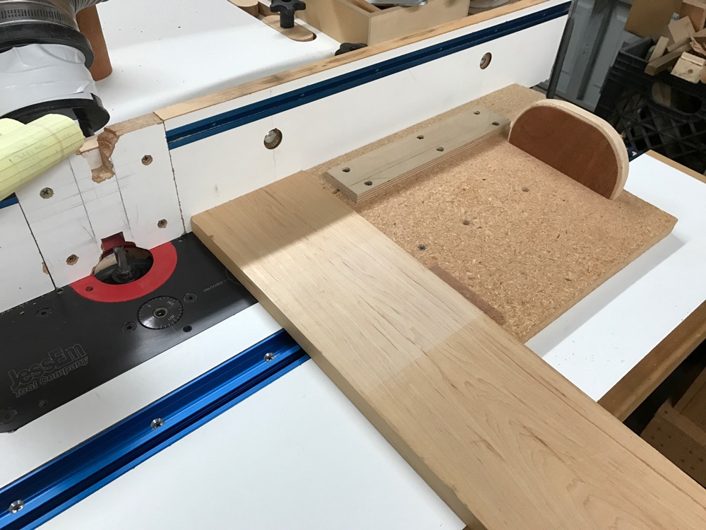

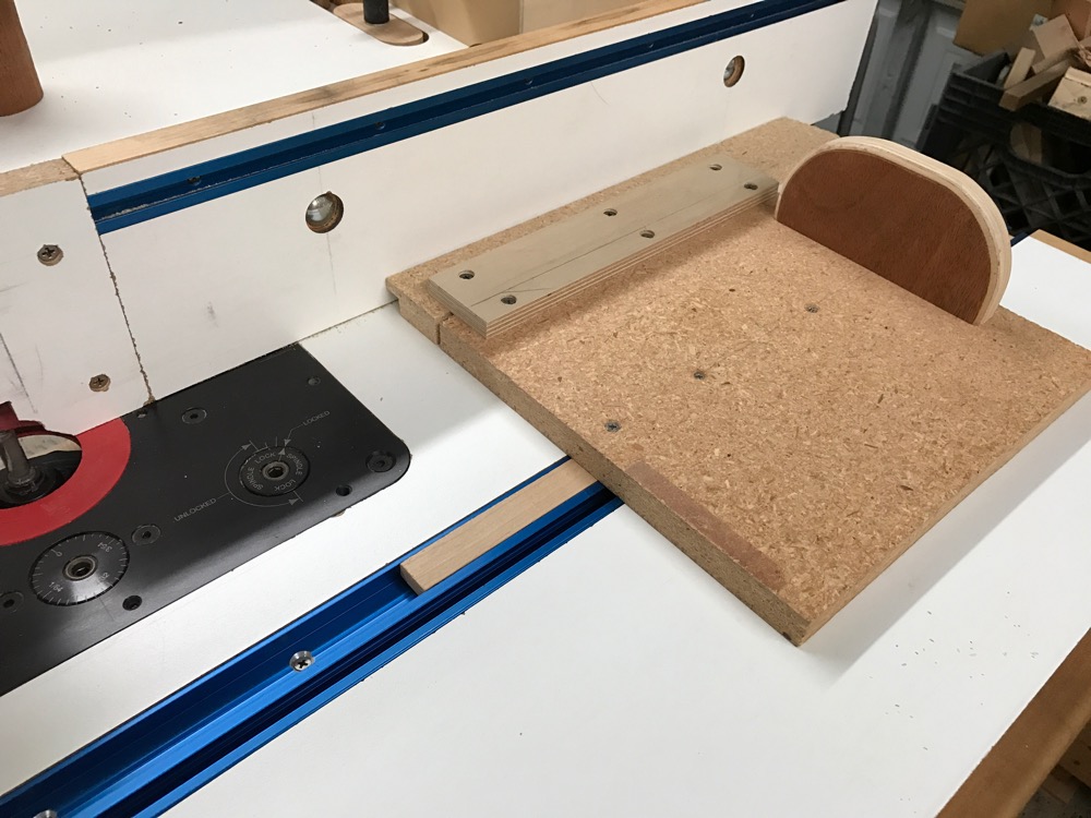

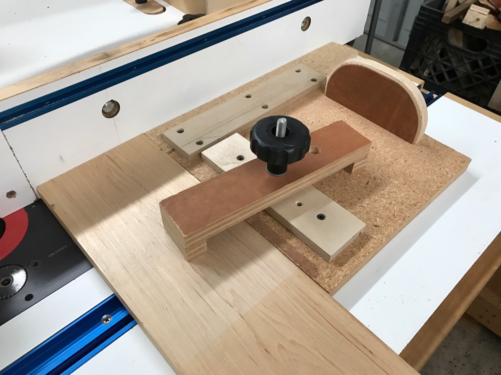

I would have to vote to have the miter track. I use mine on a fairly regular basis. It makes routing end grain far more accurate and safer. Rail and stile doors absolutely require one. I included some pictures of mine in that mode with and without hold down. The one you see here is a simple version with a sacrificial follower for various profiles. I also use a shop made tenoning jig in the same fashion.
Paul
Paul
- IMG_3742.JPG (179.87 KiB) Viewed 8411 times
- IMG_3743.JPG (186.34 KiB) Viewed 8411 times
- IMG_3744.JPG (182.97 KiB) Viewed 8411 times
