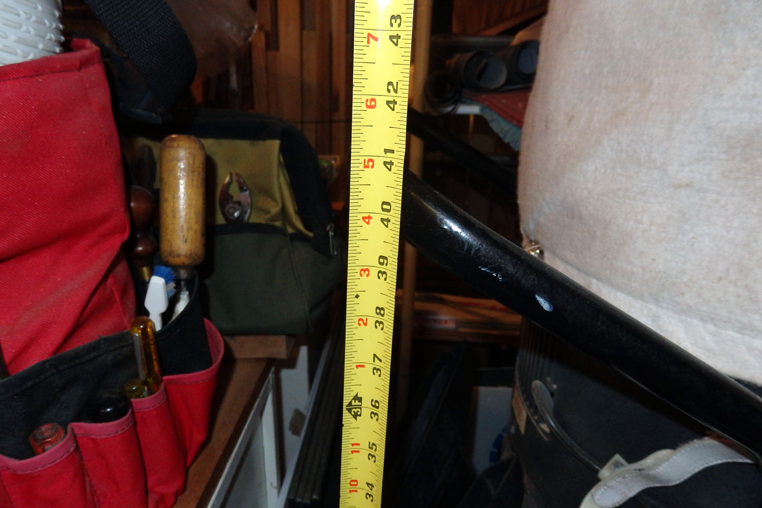

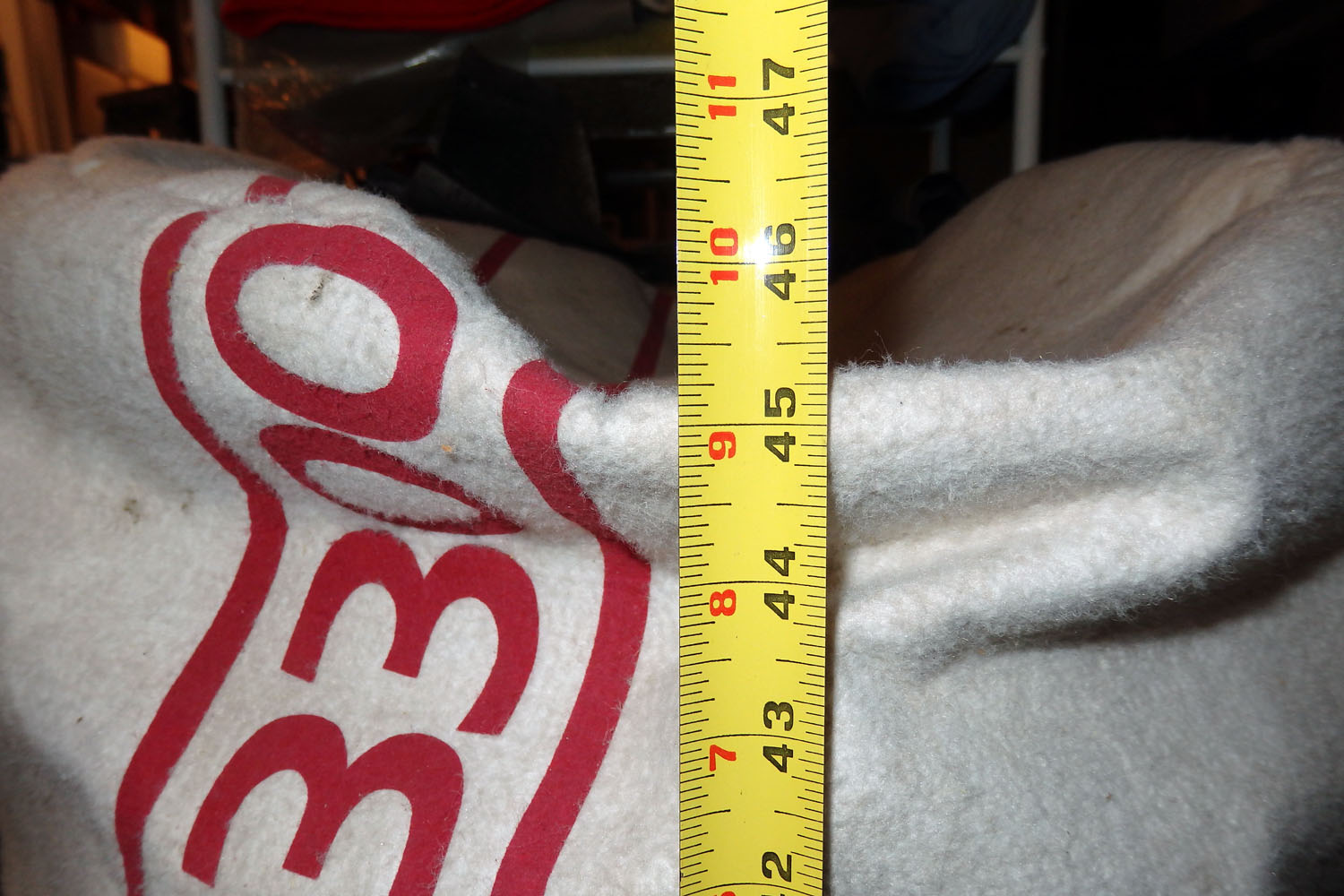

Congratulations on your upcoming acquisition! Hope these help. Also, in plan, "footprint" is about 26" x 21", if case vertical clearance is an issue when lying on its back or side.
- To top of handle
- P1161292.JPG (186.93 KiB) Viewed 5648 times
- To top of housing
- P1161295.JPG (230.32 KiB) Viewed 5648 times
