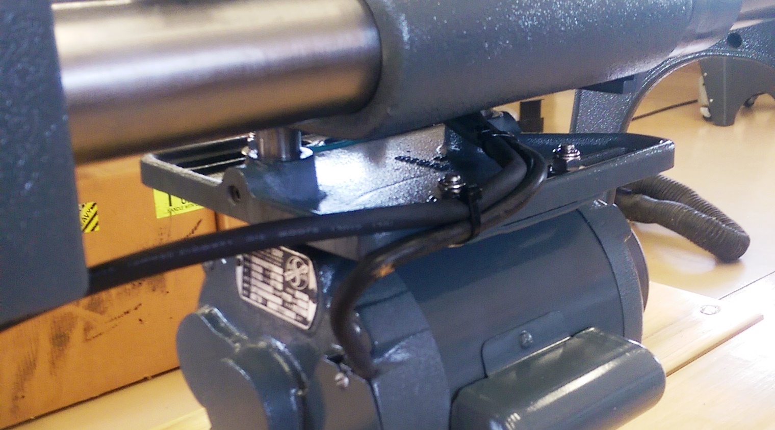

Posts: 6585
Re: SS 10er suddenly will not start
JPG wrote:One thing you need to think about is providing a strain relief(method to secure the internal end of the cord).
You will need to improvise. A simple cable clamp and screw(need to drill a hole?)will be better than the switch termination proving that strain relief.
A strain relief is certainly desirable and really needed IMHO. However, no need for a cable clamp and drilling and taping a hole (where?) for the screw. A simple nylon zip tie or two is all that is needed. Notice I have a second zip tie on the two cables above the one on the motor mount.

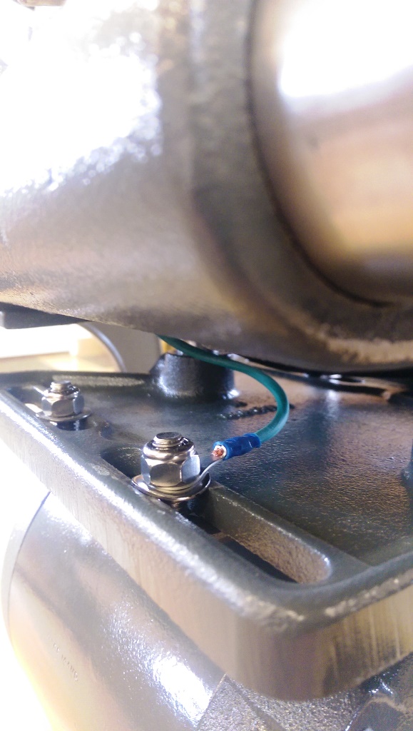

Also make sure you use a power cord with a ground. I use 12 gauge but 14 gauge should be fine in this application. I attached the ground wire to one of the motor mount bolts after removing the paint under the washer. I checked continuity every where on the machine including the quill shaft and it was fine.
