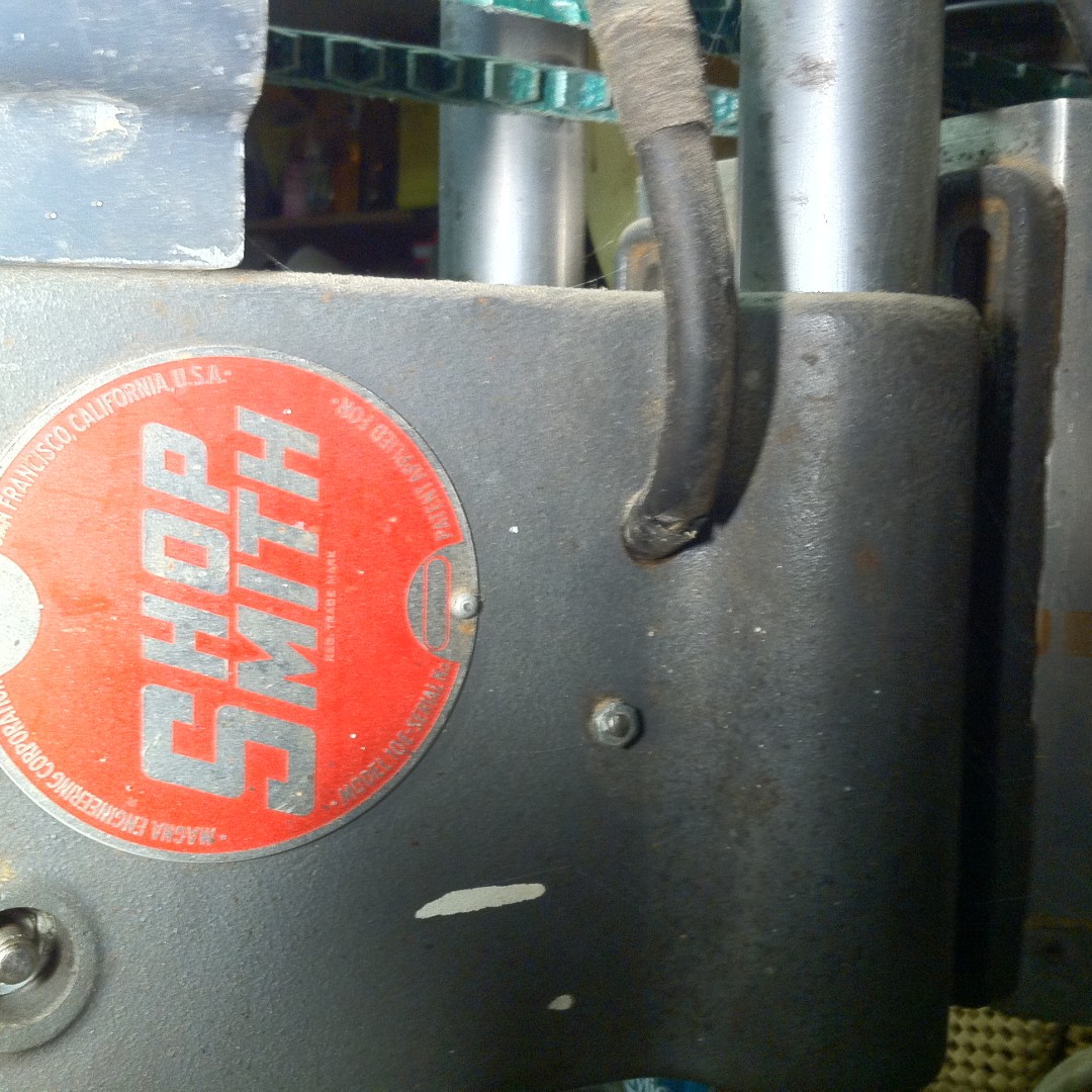

My other 10ER, (dedicated drill press), has the cord coming out though the back of the casting.
I had always assumed that it had come that way from the factory, but on closer examination I now think it was drilled by a previous owner.
There is no visible strain relief, but the cord has a very thick insulation and is a fairly snug fit in the hole. I also suspect that the small bolt just below the cord is anchoring the cord inside the headstock somehow.
Having one done each way I really can't see any advantage in drilling a hole for the cord. KISS ;)

Hello everyone,
Thanks again for the discussion and posts! I hope I can somehow return the favor.
It was the switch. I have installed a new cord to the switch, a new switch, crimping, soldering and shrink wrapping all of the connections. I did everything I could think of to secure the connections and cord, using the zip tie approach.
I opened up the motor to replace the cord from the switch to the motor and was instantly lost, so I blew the motor out, wrapped the cord where it exits the motor just to make sure, and moved on. I figure at some point this spring/summer (I work in an unheated garage)I'll pull the motor and take it to a shop.
One note-my 16yo son who builds drones and robots suggested hot glue to secure the connections. I passed on that advice, but your posts gave my son and I some great discussion fodder, which, with a 16yo is priceless.
I have everything hooked up and the motor sounds great. Following my dad's advice I am taking a break, then will go reinspect everything before really using.

Randy, Thank You for the update. I am so thankful that this worked out "for you" better than what I was envisioning. Connecting the power cord into the motor should be a rather simple task. Mine are all connected with solderless, crimped connectors. Just make sure you record which wire goes where. A few shots from a smart phone really can be a life saver.
This, by the way, is what this forum is all about; helping someone back into operation.
