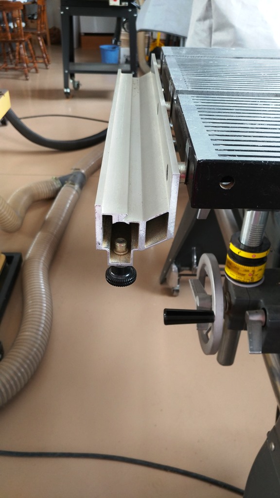

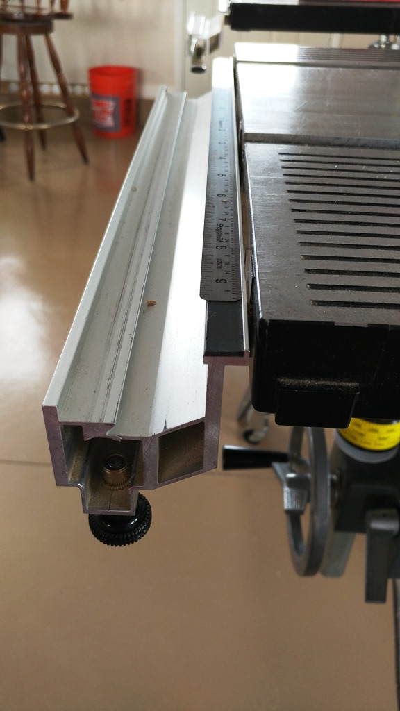

algale wrote:There are two versions of the 520 front rails. When they went with the magnetic scales, they added a little ledge that holds the magnetic strip. If
you have older front rails without the magnetic strip, the scales themselves will have no place to sit.
Thanks -- this does answer my base question and makes all of my other questions moot !!
Re: 520 Rip Scale Mod
The photos that I had in mind would have helped some.
Let it be said, however, that the rails are compatible with one another. In other words, short rails without mag strip capabilities can be used in conjunction with a mag capable front rails. Rear rails are all the same.

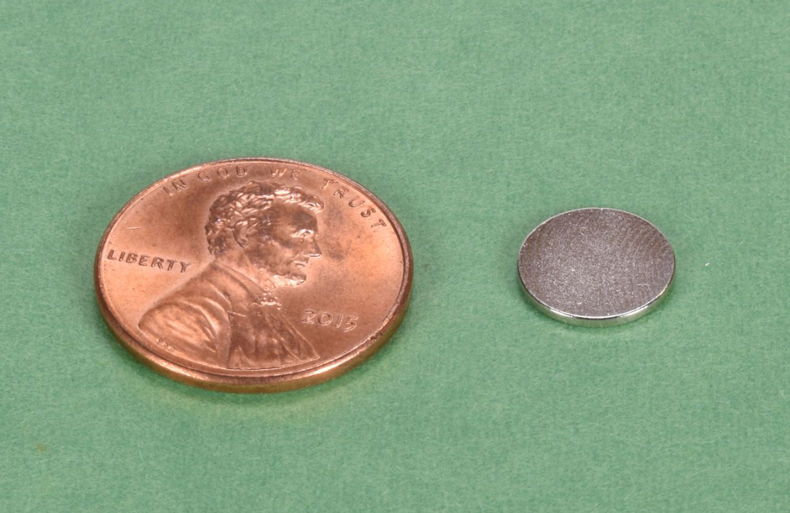

I had thought about removing the magnetic tape on the tables and replacing it with these magnets glued in place. I think they would be thin enough and since they are neodymium I presume they would be strong enough to hold the tape in place (even the long one).
https://www.kjmagnetics.com/proddetail. ... d=D601-N52
thin magnet.PNG (1.43 MiB) Viewed 8483 times

The two rails are different. The first picture is the old rail. The second picture is the newer magnetic rail.
jsburger wrote:The two rails are different. The first picture is the old rail. The second picture is the newer magnetic rail.
Yes they are different (from one another). But they are compatible. The old rails can be used on the extension and floating tables in conjunction with the new rail on a Main Table.
Posts: 6584
You are correct they are absolutely compatible. I was answering the OP's question about just adding a magnetic strip to the non magnetic rails.
