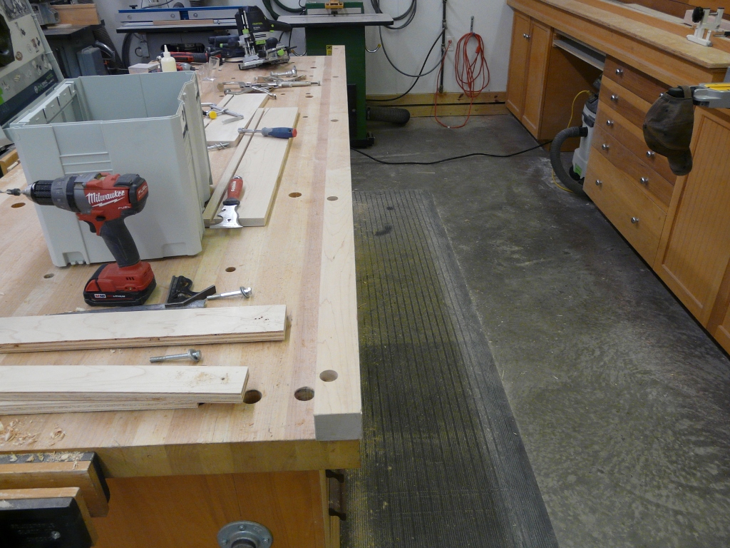

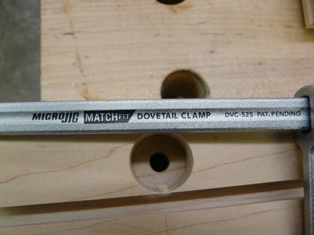

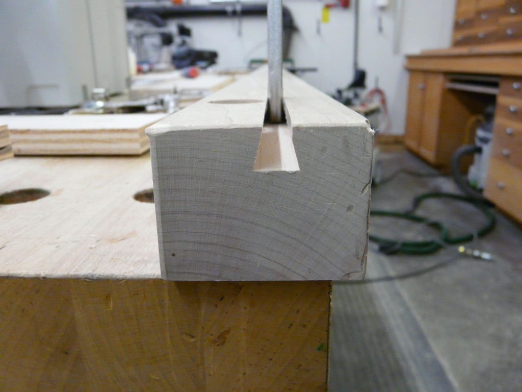

I recently bought these to retrofit to the front side of my bench.

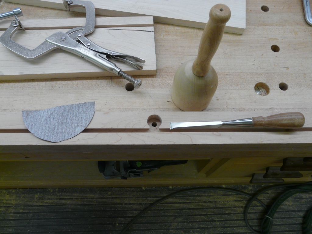

When I built my bench I recessed T nuts and made the outside piece replaceable.
Unbolted and ready to go.

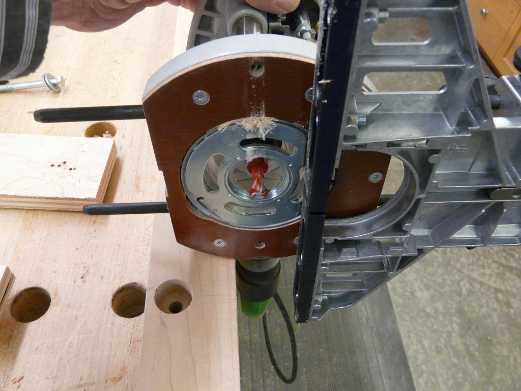

Dovetail bit installed and ready to route. This doesnt come with the clamps but they tell you that you need a 1/2" 14 degree dovetail bit.
I routed this very deeply and the result was a tight fit.
I had to do a little chisel work on the recessed bolt holds because I routed into them but I knew that going in.

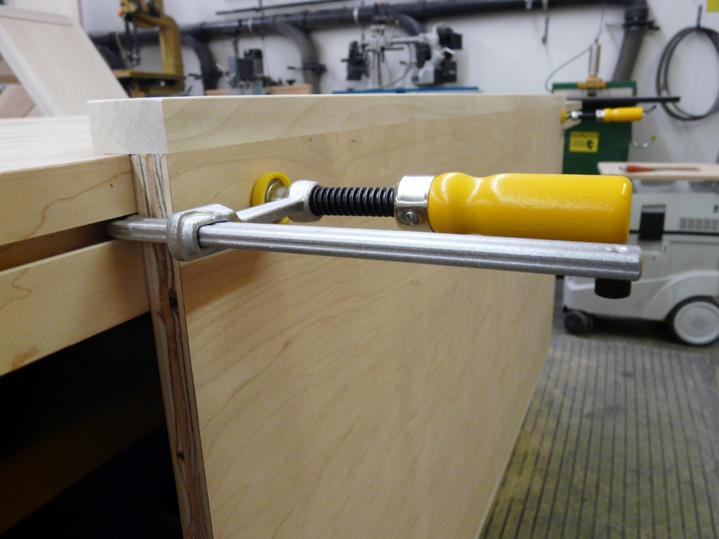

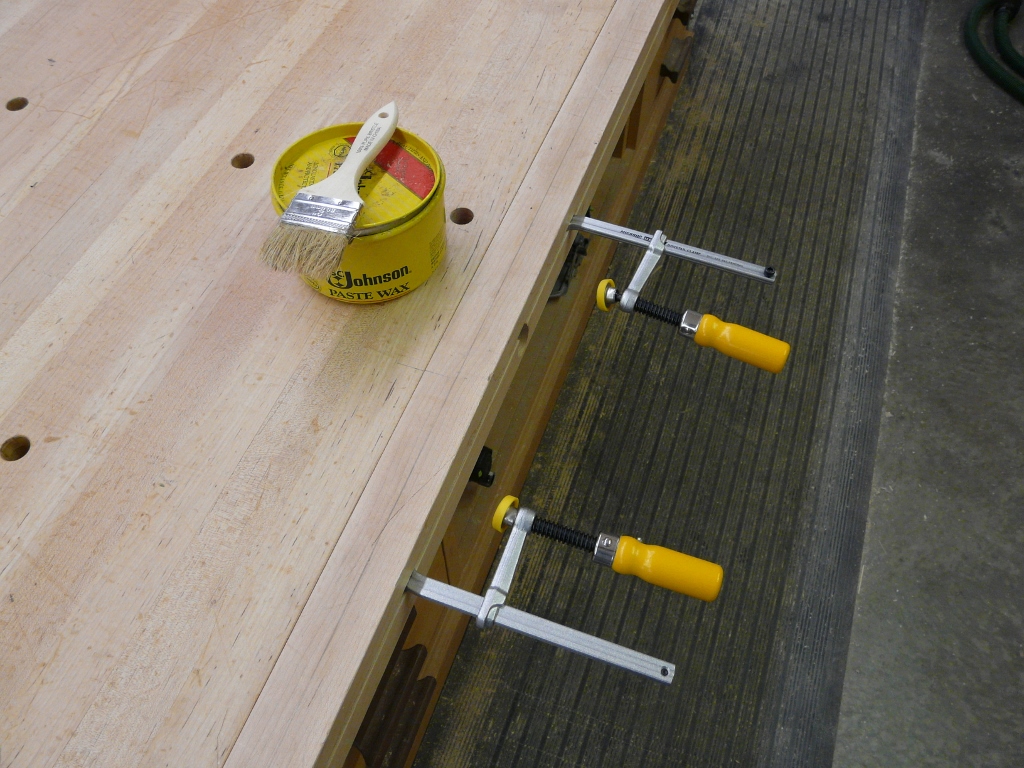

A little past wax in the groove helped with the tightness.

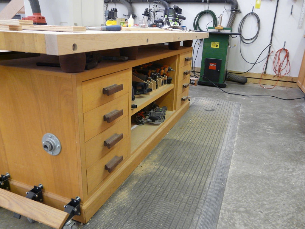

This is going to be a huge benefit for clamping and sanding shelf edges.
I highly recommend these.
Next step is to make some sacrificial fences for the table saw.
