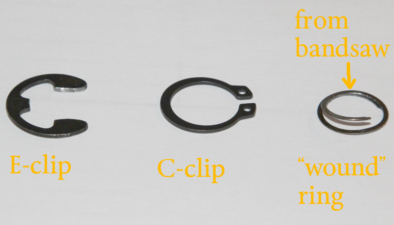

Pictured are various retaining rings. Interestingly, Shopsmith has no less than 7 retaining rings in the headstock diagram that I have for my 1982. All are simply called "ring-retaining" and are different sizes and functions.
Shown in the photo is the "wound-ring" I took from my 1982 bandsaw upper wheel shaft and replaced with an E-clip like Ed ordered and pictured.

While greasing the upper wheel bearing I damaged my "wound" ring. I'd like to replace it with an e-clip or snap ring. Does anyone know what size is needed? I couldn't find my caliper before I left for work.
Re: Retaining ring for bandsaw wheel?
lustreking wrote:While greasing the upper wheel bearing I damaged my "wound" ring. I'd like to replace it with an e-clip or snap ring. Does anyone know what size is needed? I couldn't find my caliper before I left for work.
The shaft is 1/2".

Realize the clip needs to grip the od of the slightly smaller groove.

JPG wrote: Realize the clip needs to grip the od of the slightly smaller groove.
From something I read on a machinist forum, the size of the e-clip is based on the shaft size, and assumes a smaller groove. However, I'll probably buy a 1/2" as well as a 7/16", just in case. ;)
