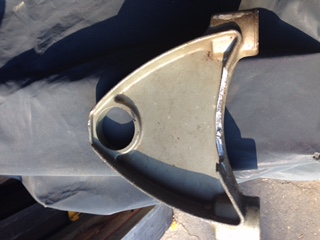

JPG: Thanks for the confidence building pictures of the other side of the hole!
I am going to do the disassemble after more travel this week. I think I see some corrosion around the tube-housing joint.
Once again: more to follow.
And thanks for all the suggestions! This issue is my adventure on this forum and it has been very helpful!

Re: Tailstock stuck in MK V
That was Reible's pix. I merely copied/posted it here.carpfisher wrote:JPG: Thanks for the confidence building pictures of the other side of the hole!

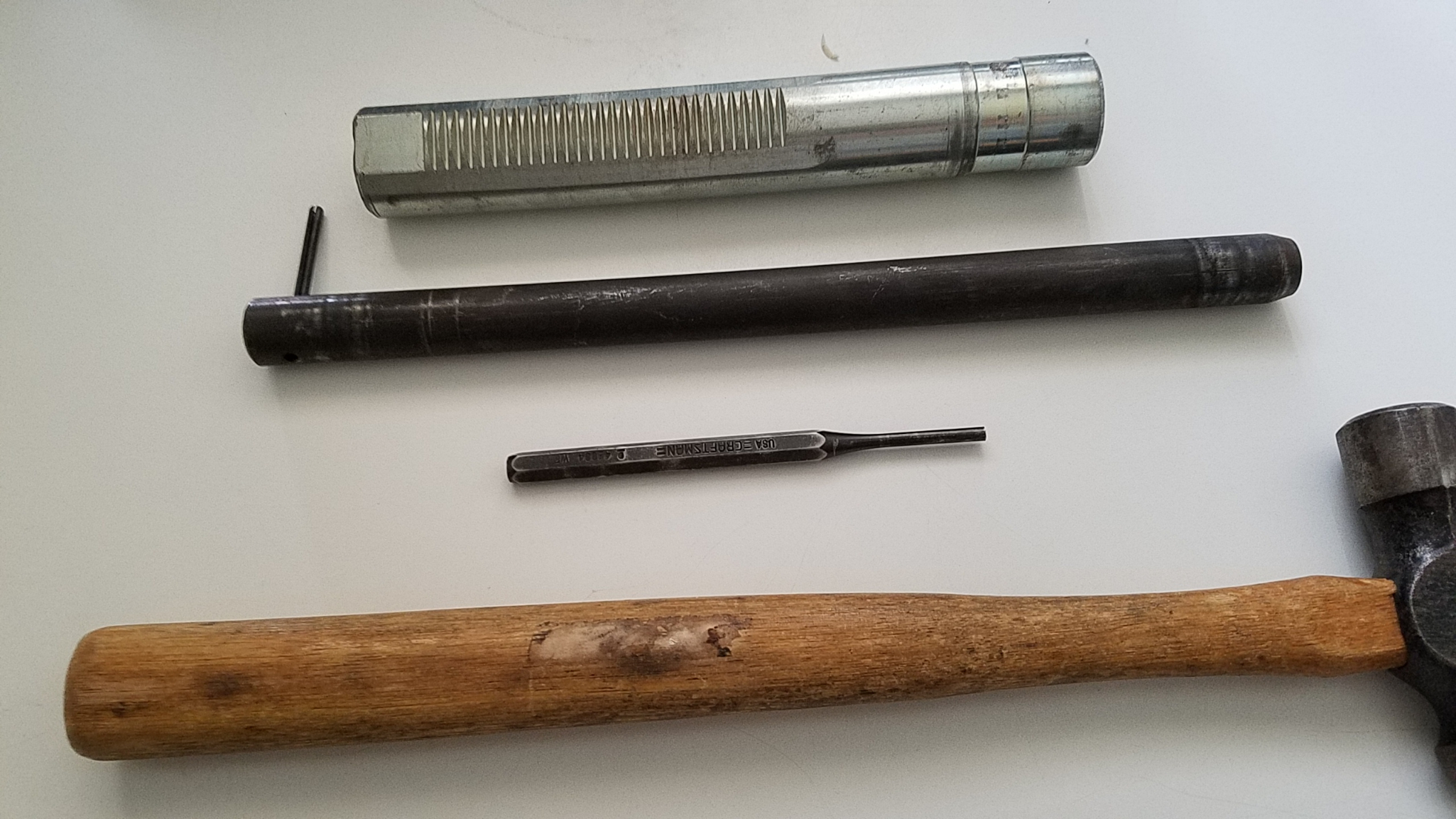

dusty wrote:Believe me, if you punch the pin clear through the hinge pin, the pin will drop out. The only way that it would not is if the casting is full of crud to prevent it from moving. Gravity works.
Take a real good look at the pin (that you are attempting to remove) and then roll the hinge pin 180° so that you can inspect the other end. What is see in picture #2 is not quite what I expected. That pin looks to be a bit mushroomed.
There was a rule on the battle field requiring that the leader always have an alternate plan of attack. Yoy might want to remove the casting from the Way and Bench Tubes.
The pin is in good shape. the pic doesn't do it justice.
My Pop purchased the MK V in 1974 or so. I don't remember him ever taking it apart. I think the the disassembly was when I removed the legs to bring it to Indiana from PA.
carpfisher wrote:dusty wrote:Believe me, if you punch the pin clear through the hinge pin, the pin will drop out. The only way that it would not is if the casting is full of crud to prevent it from moving. Gravity works.
There was a rule on the battle field requiring that the leader always have an alternate plan of attack. You might want to remove the casting from the Way and Bench Tubes.
It sounds as though you may be further along with this task than I realized.
If you have the roll pin removed you already know that it is 5/32". I used the Craftsman Pin Punch 42894 and a ball peen hammer to drive it out.
With the roll pin removed, some light tapping pushed the pivot pin out of the Base casting.
At that point, you would have the Base Arm in your hands with the Tail Stock stuck tight in the bore.
I would drive it out (as I said before) with a large rubber mallet and the short leg from the tool rest acting as the pin punch.
