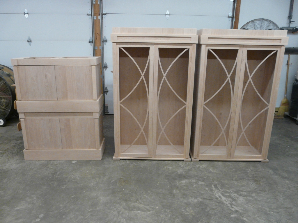

Even if I could afford it I cannot spare the room! ;)
2 (1).jpg (321.62 KiB) Viewed 9651 times
2 (2).jpg (362.12 KiB) Viewed 9651 times
This is a couple of display cabinets. The uppers will sit on the bases which are stacked one on top of the other on the left. Sorry I didn't have anyone around to help sit them up for a proper photo op.

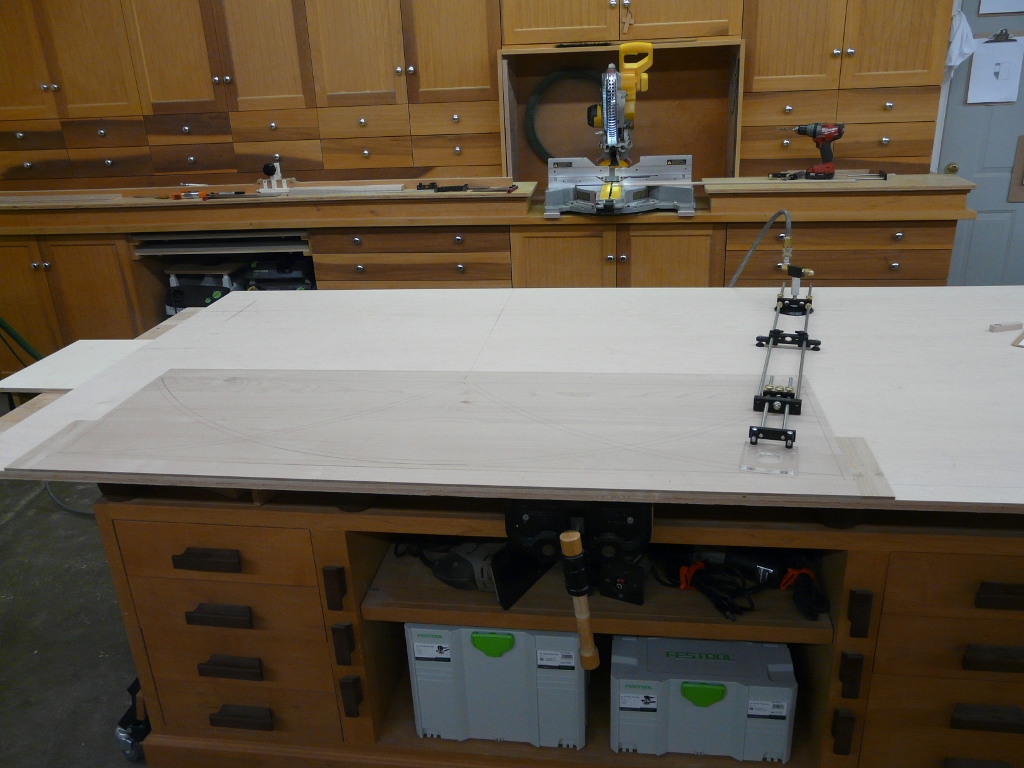

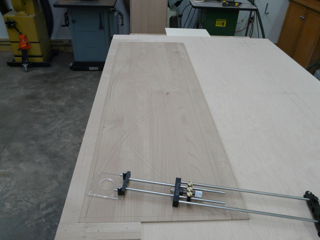

I like the design and that fact that you were able to produce it with your trammel, nice piece of equipment btw. Maybe after I get all my green tools I might bite for one of those....
Will or is there glass for support? Those pieces being as thin as they are must have some sort of support I would think????????

reible wrote:I like the design and that fact that you were able to produce it with your trammel, nice piece of equipment btw. Maybe after I get all my green tools I might bite for one of those....
http://www.microfence.com/ Great equipment and great service.
Yes they will have 1/8" tempered glass.

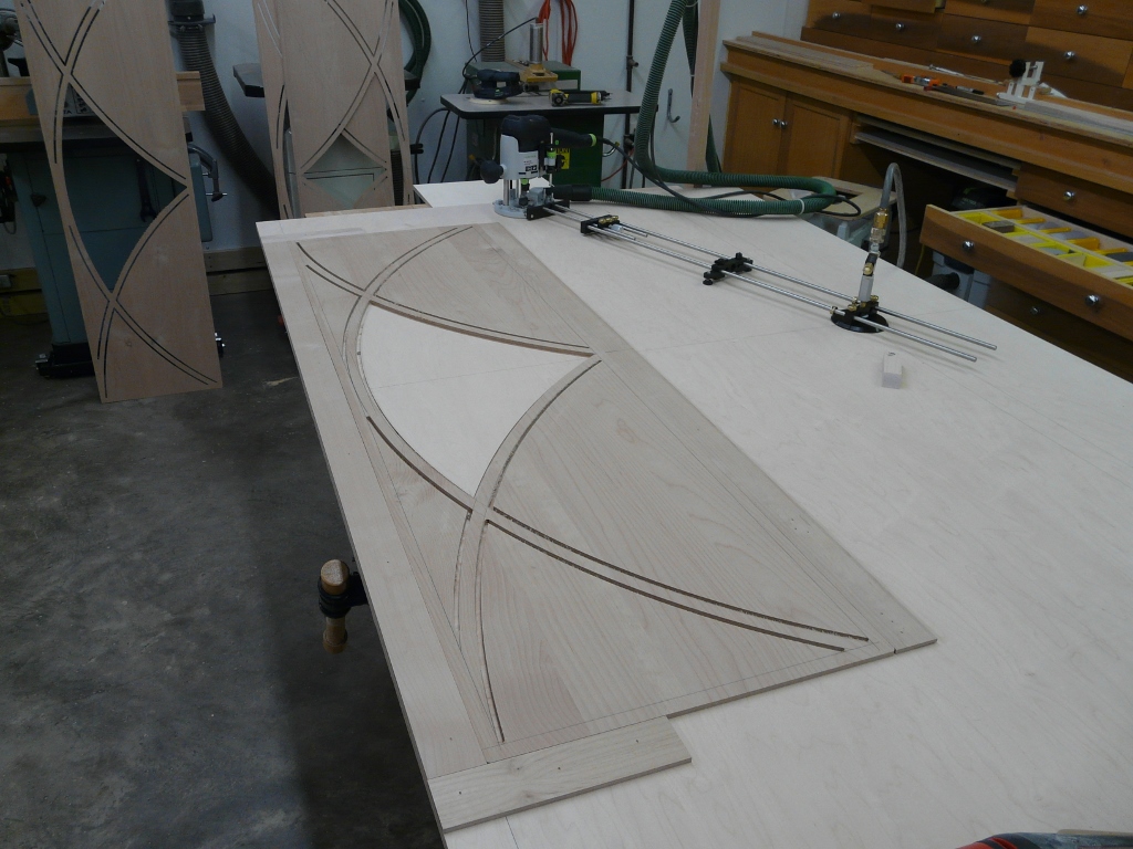

Awesome work, I have some similar looking window sash to fabricate so had a few questions.
Did you cut that out of glued up solid stock ?
Also, when installing the glass are you using 3m tape to keep the mullion flat on the glass, a silicone of some sort, or just clips at the edges?
mbcabinetmaker
Posts: 1627
Location: Greer SC
Re: I don't need no stinking CNC machine!
Post by mbcabinetmaker »
Dccarpenter wrote:Awesome work, I have some similar looking window sash to fabricate so had a few questions.
The grids are made from alder veneer on 1/4" MDF. It is pretty flat so no silicone should be needed. The glass will be held in with wooden strips attached to the back of the door with small countersunk screws.
